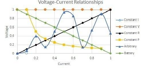

Dale is right, resistance is merely the relationship between voltage V and current I. Components do not need to be linear, nor passive, so that many relationships are possible. The picture attached illustrates a few. (The one labeled battery represents a battery with internal resistance.).
The arbitrary curve is not impossible. R could be defined as the slope of a line connecting any two points on the arbitrary curve. The value could be positive, negative or zero.
It is only when we have approximately linear materials, that R becomes nearly constant (see the black line in the chart). That is what your professor had in mind, but it is not the only possibility.
