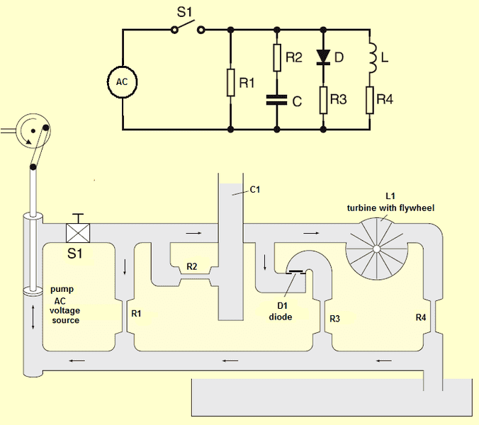

    That’s amazing. It does look like fun, thanks for sharing Jony130.
    The surge tank is there for C1, and inertia is there in the turbine’s flywheel.
    Actually, my biggest objection to the water analogy is that based on the questions I see, some water analogy students never learn pressure*flow is power. They think the flow is power, and that electrons in a circuit are like little energy capsules that deliver discrete bits of energy to the destination. Even Jony130’s clever water circuit does not help anyone visualize power versus time, only water flow versus time.
    The whole thing is exacerbated because teaching the water analogy is often 100% verbal, when pictures are really needed to clarify. Jony130’s is an example of a very clever circuit, but too difficult to explain without a picture.

    Water analogy (just for fun)
    [ATTACH=full]97999[/ATTACH]
    As you can see Inductor water analogy is a turbine with a flywheel. The mass of the flywheel determines the value of a inductor inductance.

    Glad you enjoyed it. Just yesterday, I saw it again in the press — “this wind farm makes up to 100 MW per year.”
    “”The water analogy does not work for AC.”
    It does work, but you have to switch the direction of water flow (I) and the direction of height difference (U) at the same time.”
    Well yes, but you have to embellish the water analogy a lot. Reservoirs on each end instead of a hose with nozzle, something like surge tanks to analogize capacitors, and something like a fluid with intertia to analogize inductors.

    “The water analogy does not work for AC.”
