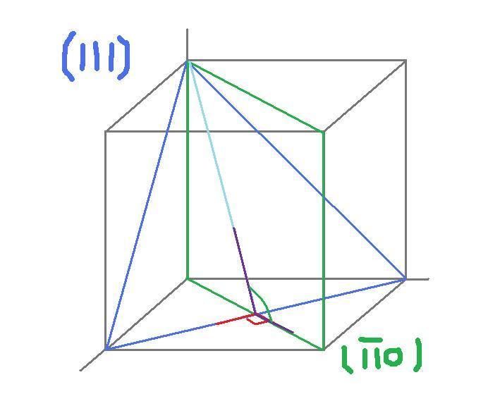

Indicate the (111) and ([11]0) ([11] has an over line, so is negative, don't know how to do on forums!) planes in a cubic lattice in a diagram, then calculate the angle between them.
I think I have drawn this right (see attatchment), but I am not sure what angle it is referring to.
I would guess it is 90 degrees (in red), but I doubt I would be asked this, maybe the other angle (purple), could someone give any thoughts?
Also if my drawing is wrong, let me know! I wasn't 100% sure about the negative (110)
Take the angle between the normals to the planes. It will eliminate ambiguity and it will be much easier. You should know what vector is normal to the plan (h k l) if you studied reciprocal lattice.
