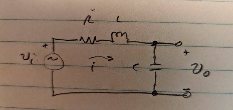

Just to elaborate a bit about Laplace in the EE world. Consider an RLC low pass filter.
A physics student would write out something like
##v_i = Ri + L \frac{di}{dt} + \frac{1}{C} \int{i}{dt} ##
##v_o = \frac{1}{C} \int{i}{dt} ##
and proceed to solve the DEs
An analog EE would use the familiar voltage divider formula with complex impedances and just write out the solution in the ##s## domain immediately.
##\frac{v_o}{v_i} = \frac{ \frac{1}{sC} }{R+sL+\frac{1}{sC}} = \frac{1}{1 + sRC + s^2LC}##
Chances are we'd never invert it into the ##t## domain but just look at Bode plots and such. Our spectrum analyzers and FRAs give us the frequency domain data anyway. Many of us work in the frequency domain most of the time. If we needed to invert the transform, we'd first look in a table of common transform pairs.
IMO, Laplace transforms are the basis for phasors and complex impedances, even though they aren't taught that way initially. You can always set ##s=j \omega## and do that complex arithmetic when needed.
