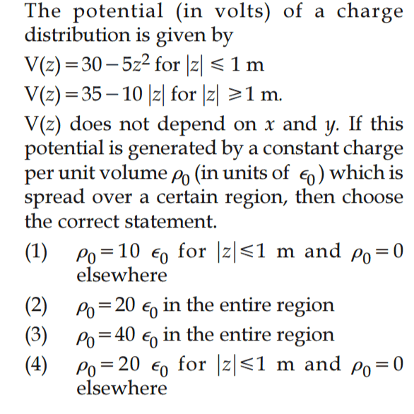

In the region |z|<1 ,
E(z) = -dV/dz = 10zk
This means there is a variable electric field in the region -1<z<1 .In the +z region it is directed in the +z direction and vica versa .
For finding the charge density in the region 0<z<1, I need to apply Gauss's law . I am not supposed to use differential form of Gauss law .
Consider at a distance z from the origin a thin cuboid of side a×a and height ∆z .
The two square faces are at distances z1 and z2 , z2>z1
Flux through the closed cuboidal box would have a contribution from only these two square surfaces which are perpendicular to the electric field .
Net flux = E(at z2)a2 - E(at z1)a2 = 10a2z2-10a2z1
Applying Gauss law ∫E⋅ds= ρa2∆z/ε
10a2z2-10a2z1 = ρa2∆z/ε
10a2∆z = ρa2∆z/ε
ρ = 10ε in the region 0<z<1
Is that right ?
Please help me with this problem .

Your work looks correct to me.

The electric field is directed in the +z direction for 0<z<1 .
For z>1 , there is a constant electric field in the +z direction .
Here I need to prove that there is no charge anywhere in z>1 .
For this I can again consider a cubical shaped box of dimensions a×a×a , such that there will be two square surfaces perpendicular to the electric field .
Since the electric field is constant the net flux through the closed cubical surface would be zero .
Applying Gauss law the net charge enclosed would be zero .
This means there would be no charge anywhere in the region z>1 .
Is that sufficient reasoning ?
Would 1) be the correct option ?
That looks good. Strictly speaking, I think your arguments yield the average charge density, ρavg, in the rectangular boxes you used. But it should be easy to go on to argue how to get the charge density, ρ, at any point.
If we consider a cubical box of dimensions of infinitesimal length dx , dy , dz , do we get charge density at a point .Is this what you are indicating at ?
Yes. Good work.
