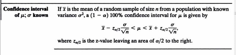

Find a 95% confidence interval for [tex]\theta[/tex] by using that [tex]\frac{\hat{\theta} - \theta}{\sqrt{\frac{2 \hat{\theta}}{n}(1-\frac{\hat{\theta}}{2})}}[/tex]
Can I use this formula?
With n=100 and [tex]\Sigma^n_{i=1}X_i = 32[/tex] I get
[tex]\hat{\theta}=0.64[/tex], but using the formula above gives doesn't give me the correct interval, which is [0.46, 0.82]
Edit: I get the right interval when I don't include the [tex]\sqrt{n}[/tex] in the formula above. Is the formula wrong?
You used the wrong formula. You have to derive your own confidence interval formula.
I assume you meant to say that [tex]\frac{\hat{\theta} - \theta}{\sqrt{\frac{2 \hat{\theta}}{n}(1-\frac{\hat{\theta}}{2})}}[/tex] is standard normal.
Then [tex]P(-1.96<\frac{\hat{\theta} - \theta}{\sqrt{\frac{2 \hat{\theta}}{n}(1-\frac{\hat{\theta}}{2})}} <1.96 )=0.95[/tex]
Now rearrange to get
[tex]P(\text{thing}<-\theta<\text{other thing})=0.95[/tex]
and then finally
[tex]P(-\text{thing}>\theta>-\text{other thing})=0.95[/tex]
