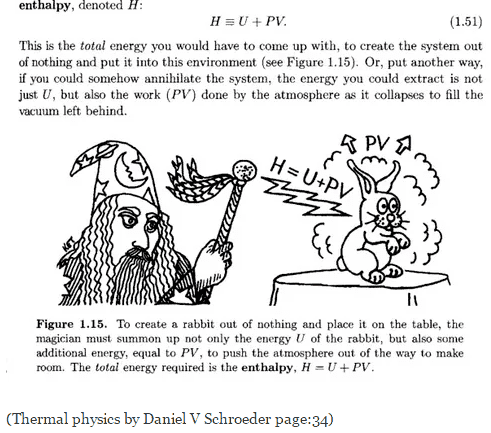

but isn't the internal energy attributed to the Kinetic energy possessed by the atoms by virtue of the temperature or heat energy ?, so shouldn't the internal energy be zero at 0 kelvin. Therefore internal energy shouldn't contain the rest energy which is independent of temperature or kinetic energy of the atoms ? Its the energy by virtue of its mass and not by its motion ?
This question arised from the description of enthalpy here https://www.quora.com/What-are-the-intuitive-explanations-of-internal-energy-and-enthalpy
I am attaching the snipped that the author had presented there.
I felt to create the system, we first need energy to create matter itself and that is not being considered.
Internal energy is the sum of all energies of a system except the kinetic energy of the whole system and its potential energy in external fields. That means it consists not only of the thermal energy but of any kind of energy within the system including internal potential energy, rest energies of particles and even vacuum energy.
