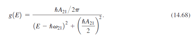

Find the frequency spectrum of the radiated power in spontaneous emission and use it to find the DOS.
Desired result below
All I'm reallly confused on this problem is what the expression for the emitted field is. As long as I've got that, I'm good to go, but I just don't know what to use. I've tried looking for an expression for the emitted field but I've had no luck. Would appreciate any ideas or someone telling me I'm missing something obvious.
(I'm told to find the Fourier transform of the field and go from there, which is why I'm trying to find the expression for the field)
Equation 14.68: g(E) equals hbar times A21 over 2 pi, divided by (E minus hbar omega21) squared plus (hbar A21 over 2) squared, the whole squared.

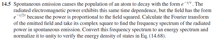

Yeah, it is:
Text problem 14.5 on spontaneous emission: population decays as e^(-t/τ), radiated power as e^(-t/2τ), asking for Fourier transform of emitted field, frequency spectrum of radiated power, and normalization to verify density of states in Eq. (14.68).
where eq 14.68 is what I have in the original post.
So the problem tells you that the field is ##\propto e^{-t/2 \tau}##, i.e., ##f(t) = C e^{-t/2 \tau}##, with C a constant. That is your starting point.

Fair enough. For some reason I thought there would be another term that also has some other kind of dependence, along with ##f(t) = C e^{-t/2 \tau}##. How in the world do I go about finding C though?
So I've gone and tried ##f(t) = Ce^{\frac{-t}{2\tau}}##, but that does not give me the correct answer. It actually comes close, but I get ##E^2## instead of ##(E - \hbar \omega_{21})^2## like my answer is supposed to be (correct answer in OP), which makes me suspect my electric field expression is still incorrect. If anyone has any insight I'd appreciate it.
