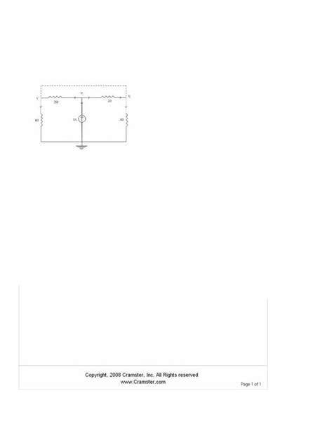

Ok i have a problem with the supernode. So this is what i done so far
V3-v1=10
now for supernod equation, this is where idk if I am correct
v1/4+ (v1-v2)/2+(v2+v3)/2+(v3/8) = 0
Is this setup right ?
Where do i go from here ?
There's supposed to be an accompanying picture of the circuit, right? You forgot to include that.
here i uploaded it, heh. I forgot this is only jpeg :D. Please help me, and explain why this occures
I really can't read the value of the current source in the circuit diagram. Could you enlarge the picture?
