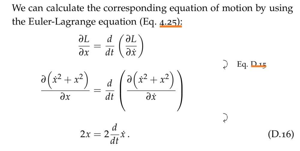

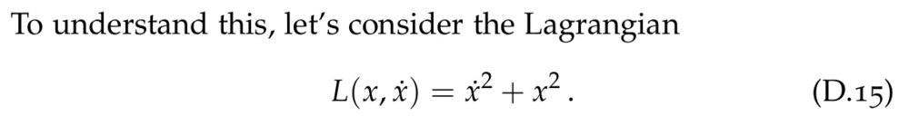

I'm reading a book on Classical Mechanics (No Nonsense Classical Mechanics) and one particular section has me a bit puzzled. The author is using the Euler-Lagrange equation to calculate the equation of motion for a system which has the Lagrangian shown in figure 1. The process can be seen in figure 2. What I don't understand is this:
He seems to consider that the partial derivative of (dx/dt)2 with respect to x is zero. Same thing for the partial derivative of x2 with respect to dx/dt. This doesn't seem obvious to me and I haven't found any explanations elsewhere. Why is it so?

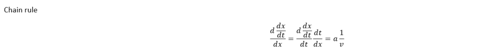

Looks like derivatives are assumed to commute: d(dx/dt)/dx=d(dx/dx)/dt.
However, if position is a function of time, it does seem meaningful to ask how the velocity is changing from one position to the next. To take it as saying velocity is not changing with position is problematic, since velocity usually does change with position. For any position-dependent force, d^2(x)/dt^2 is a function of x:
d^2(x)/dt^2=f(x) -> dx/dt = ∫f(x)dt = ∫f(x)(dt/dx)dx = v(x)
so to make sense of this you need t(x) to evaluate (dt/dx), which is not always a function
But it is odd that d(dx/dt)/dx=0 implies that velocity is constant with position. Can anybody correct/explain?
edit: differential operators do not, in general, commute, so if it is not a mistake in the text, then there is some special condition that makes it so.

In Lagrangian mechanics, position and velocity are independent variables.

This is a common misunderstanding. The Lagrangian is initially analysed as an abstract function of the dynamic variables. In which case, ##x## and ##\dot x## are taken to be two abstract independent variables and the functional format of the Lagrangian is analysed.
The Euler-Lagrange equation then specifies how these abstract quantities are related for the specific trajectory of a particle in this system.
This is done by assuming that the action is stationary for an actual trajectory. This is known as the Lagrangian principle and can be shown to be equivalent to Newton's laws. The principle is, however, much more generally and widely applicable than Newton.
Either your textbook failed to say any of this or you just skimmed past it!
