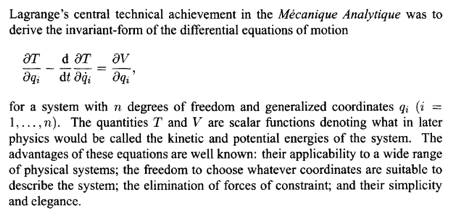

The Preface of the translation has this
From the wiki in Post #2
"William Rowan Hamilton in 1834 and 1835[29] applied the variational principle to the classical Lagrangian function ... to obtain the Euler–Lagrange equations in their present form."
Taking the two comments together, I would GUESS that Hamilton actual created what we call the Lagrangian.

The introduction to the translation provides some insights.
