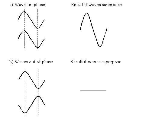

It is said that a coherent light beam is described by a single wave because all the individual waves add up in phase to produce a single big wave.
Diagram comparing two sine waves: (a) waves in phase, peaks and troughs aligned, with a summed result of a larger single wave; (b) waves out of phase, with the summed result being a flat line.

These two descriptions are similar and have been a source of confusion for years for me, even for the teachers at my university. They asked me to find out what the difference between light "described by a single wave" and light "described by a single wavefunction" is.
From the pictures above, I see no difference between coherence and entanglement, so the Internet won't do for explaining the difference to me. Please do so yourself.

But coherence means constant phase difference. Adding waves with constant phase difference gives a single resultant wave, with higher or lower amplitude.
Therefore, coherent light is described by a single wave. A wave which is a displacement measured in micrometers from the equilibrium position of the electric force.
And entangled photons have the linked quantum state, which means their probabilities of having a state are connected. Wavefunction refers to probability, not to displacement from the equilibrium position of a force.
So entangled photons have linked probabilities and coherent photons have linked displacement vectors.
My question is, why can't coherent photons also considered to have linked quantum states? Doesn't linking displacement vectors also link probability amplitudies?
