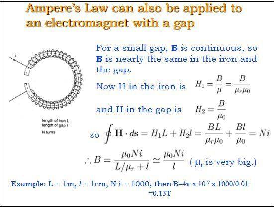

This is a slide from my lecture illustrating how to find the magnetic field in a solonoid with an air gap.
I don't quite understand the following points:
What is the H field?
Whats the difference between the H field and the B field?
Why do you need them?
Other than that i understand how to do the integral and the evaluation. I just don't understand what the H field is.

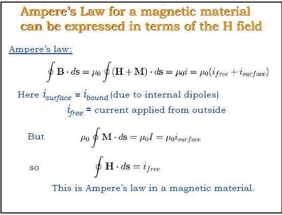

EDIT: I attached a nother slide about the H field
