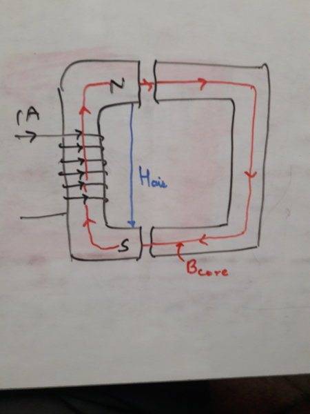

Consider the following diagram.
Because of the current in the coil, the core is magnetized and N-S poles are created near the air gaps. Is this correct? The B-field is directed from S to N inside the coil and from N to S outside the coil.
The H-field in the air gap is shown in blue. Is its direction correct? As per my understanding, the blue Hair is equal to Hcoil+Hpoles, where both are directed downward in the blue air gap.
But "inside" the coils, Hcoil is upward and Hpoles is still downward, so they oppose each other.
Is that correct?

The blue ## H_{air} ## is incorrect. In the transformer piece to the right, you will have another south pole on top, and a north pole on the bottom. This will result in two very short gaps in this configuration. You will get very little flux emerging from the square path that has two air gaps. It all stays in the square path. The magnetization ## M ## and the ## B ## can be assumed to be the same in both pieces. ## \\ ## Meanwhile, if you removed the piece at the right, then your ## H_{air} ## would be approximately correct, but the MMF equations do assume a continuous flux and really work best with small gaps. ## \\ ## With the right piece in position as in the above diagram, the ## H_{air} ## will go from north pole to south pole across the short gaps in both places.

Charles Link said:
The blue ## H_{air} ## is incorrect. In the transformer piece to the right, you will have another south pole on top, and a north pole on the bottom. This will result in two very short gaps in this configuration. You ill get very little flex emerging from the square path that has two air gaps. ## \\ ## Meanwhile, if you removed the piece at the right, then your ## H_{air} ## would be approximately correct, but the MMF equations do assume a continuous flux and really work best with small gaps.
Yes, you are right!
But if the core was continuous (without the two small air gaps), would the direction of the blue Hair be correct?
Basically, is the following reasoning correct?
Assuming no other air gaps in the core (just like in a normal transformer core), if we make a round trip from S to N "inside" the coil and N to S outside the coil along the blue air-gap line, we will encounter two H-fields, Hcoil and Hpoles.
Hpole will always be from N to S, but Hcoil (due to Biot-Savart) will be from S to N "inside" the coil and from N to S "outside" the coil. Hence, inside the coil, both H fields oppose and outside the coil (in the blue air gap), they add.
If the core were continuous, there would be no poles. The magnetization ## M ## would be uniform in the clockwise direction. Poles occur as a result of a non-zero ## \nabla \cdot M ##. (## \rho_m=- \mu_o \nabla \cdot M ## ).Basically, if ## M ## is uniform, you don't have any poles. ## \\ ## You do not get any poles from the coil itself. It has a direction and so you can label one end north and one end south, but these are not poles. You only get poles if you have a gap, e.g. if you remove the piece on the right, or have small gaps when the piece on the right has air gaps.

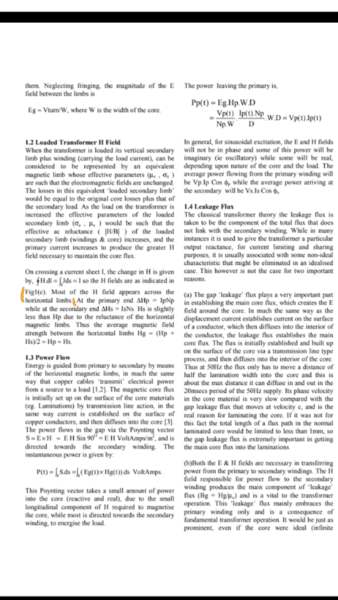

The reason I started this thread is I am interested in knowing the H-field in the region between the limbs. I have been reading this paper on power flow in a transformer using Poynting vector. (Full pdf is attached below).
On the second page (orange marks), it says "most of the H-field appears across the horizontal limbs."
What is the source of this H-field?

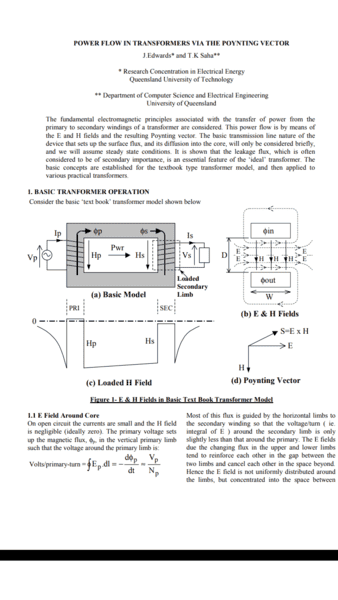

  • Power_flow_in_transformers_via_the_poynting_vector.pdf

In this wikipedia article, it is said that there are two components of the H-field in a magnetic material, one is from free currents and the other is from bound currents' demagnetizing field.
https://en.wikipedia.org/wiki/Magnetic_field#H-field_and_magnetic_materials.
Inside the magnetic material, this demagnetizing H-field is in the opposite direction to that of the magnetization. But in the above diagram, if the core is continuous, there will be no poles. So where will this demagnetizing H-field start and end?
Could you explain this last line of that article?
"The magnetic H-field, therefore, re-factors the bound current in terms of "magnetic charges". The H field lines loop only around 'free current' and, unlike the magnetic B field, begins and ends near magnetic poles as well."
The imperfect geometry of the rectangular form, (as opposed to a more regular torus), makes for much more possibility to have regions where the magnetic pole density ## - \mu_o \nabla \cdot M=\rho_m ## is non-zero. Unlike a toroidal geometry, there necessarily will be regions where magnetic poles appear. ## \\ ## I was able to determine with a proof of the equation ## B=\mu_o(H+M) ##, that the ## H ## as defined as previously discussed, consisting of the contributions from poles as well as from currents in conductors is quite exact, but I have yet to do a similar type of derivation for the ## H ## in the Poynting vector equation. If indeed that ## H ## is one and the same, the imperfect rectangular geometry will give some additional regions of significant ## H ##. This is where I need to study it further though. Until the Poynting vector is given a more thorough study, it is uncertain for me whether the field of interest is ## H ## or ## B ##. In addition, the transformer case is more of a DC and/or longitudinal type electromagnetic behavior, where the wavelength at the frequency that transformers operate is extremely long. The problem is interesting, but it really is beyond my present level of what I can readily compute. ## \\ ## Additional input: I think it might be worthwhile to work with a toroidal geometry, and see if the same conclusions can be reached. I think the energy flow would perhaps be even more efficient for the toroidal case, but it might put a damper on the conclusions that the authors have reached. ## \\ ## And another additional item: I haven't studied the paper in full detail, but I would imagine the electric field ## E ## from the Faraday EMF is the source of the ## E ## for the Poynting vector. It remains to be seen what exactly the ## H ## is that needs to be employed here. If a toroidal geometry is used, I think the ## H ## from the coils in principle covers a path that goes around the whole toroid. Meanwhile, the power transfer can be quite significant, and I would be rather surprised to find that a "leakage" flux is responsible for any significant amount of power transfer. It might be the case that it is responsible for significant power losses, but I don't think it could ever be concluded that the power transfer depends on this. ## \\ ## One detail I haven't ironed out yet is that ## N_p I_P=N_s I_s ## , but I believe the ## H's ## from these are basically equal and opposite. Somehow, I'm expecting this is where the power transfer occurs, but I need further study of the problem. One possibility is it is the same type of calculation involving two electrical charges, where the electric field of interest for a single charge is the one that comes from the other charge, and it doesn't experience a force from its own electric field. ## \\ ## @vanhees71 My experience with the Poynting vector is somewhat limited. Might we have your input on this paper of post 16 ? I am starting to believe that the authors are incorrect in determining that a "leakage" flux is responsible for the power transfer. Perhaps the Poynting vector analysis is rather straightforward. Perhaps you can show us that this is the case. ## \\ ## And I didn't have time to read this paper yet, but perhaps it is more accurate than the one of post 16. Just a quick reading of it, it appears it may have the answer: http://www.hep.princeton.edu/~mcdonald/examples/transformer.pdf
I read the paper. Accoring to the author, the energy flow from primary coil to secondary coil depends on two things:
1) The E-field in the central air gap region of the toriod due to the changing B-field in the toroidal core.
2)The H-field in the same central air gap region of the toriod due to the "conduction currents".
This ExH gives the Poynting Vector carrying the load power.
Now, in case of an ideal toroid, all the magnetic field is contained "inside" the core. But here, there exists an H-field in the central air gap of the toroid due to the "conduction currents". Doesn't this suggest that this is the "leakage" flux that is used in the power transfer?
I may be wrong here.

I think the conduction currents can be minimized with laminations. See posts 19 and 20 of this thread, especially post 20 where @jim hardy gives an important input: https://www.physicsforums.com/threads/magnetic-flux-is-the-same-if-we-apply-the-biot-savart.927681/
I am not sure we mean the same thing by "conduction currents". In the paper, conduction currents are the primary and secondary currents. And Jim's response in that thread is about how "eddy-currents" can be minimized with the laminations.
I now have read the paper of post 19, although still somewhat quickly. The conduction currents are those of the ## I_p ## and ## I_s ## including the windings as well as any additional leads. The displacement current ## \frac{\partial{D}}{\partial{t}} ## is being considered because Maxwell's (MMF) equation/Ampere's law actually reads ## \nabla \times H =J_{conductors}+\frac{\partial{D}}{\partial{t}} ## for the non steady state case. The term ## \frac{\partial{D}}{\partial{t}} ## is known as the displacement current. ## \\ ## It does appear that the Poynting analysis determines the energy travels through the air across the core. ## \\ ## It's somewhat interesting, but whether this result has any practical application remains to be seen. When you consider simple DC or AC circuits, the usual approach is to consider the power transfer as happening inside the conducting wires. As a graduate student, I once had a fellow graduate student make the argument that the electromagnetic energy actually travels around and outside the wires. He may have been right, but I normally find the simpler explanations as being more useful for practical applications.
