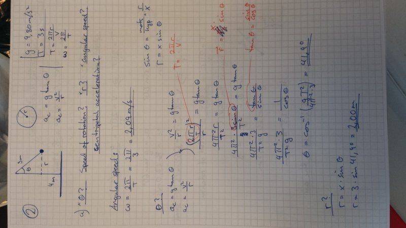

A child is sitting on a wooden stick, hanging from a 3 m long blue rope,
attached to the top of a 4 m tall metal pole. The child is performing uniform
rotation around the pole, in such a way that the angle between pole and rope
is . The horizontal distance between child and pole is called r.
The centripetal acceleration resulting
from the combined forces of rope and gravity is given by
ac = g tan
where g = 9.80 m/s2 is the gravitational acceleration.
If the period of rotation is T = 3 s, what is:
a) What is the angle ? The speed of rotation? r ? The angular speed? The
centripetal acceleration?​

I have found out (in a)) that the angle is 41.9 degrees, r =2m, angular speed=2,09m/s, centripetal acceleration=8.79m/s^2, and the speed of rotation=4.19m/s

Simon Bridge said:
Please show your working and not just the answers - seeing this helps us to understand how you think so we can answer your questions properly.
Okey, so I have uploaded two pictures which shows how I have done (a) and (b).
And for (c) I first thought about using x(t)= xi + vit + 1/2 at^2 but that does not include the angle so it feels wrong..

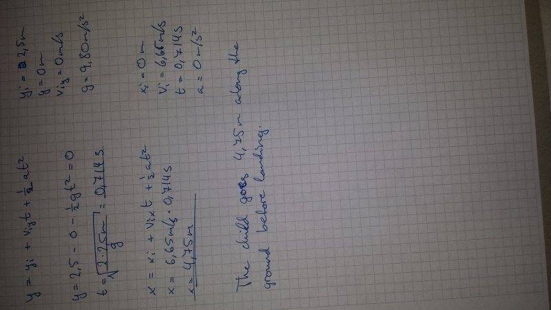

Based on that you are given this problem, I believe you will already have covered basic parabolic motion under the influence of a gravitational field, yes? What is the initial velocity in the vertical direction and how does this change with time?
Okey, I think I've sorted it ou based on your last question. Does this look right to you?
Your approach looks reasonable, I have not checked the actual numbers.
Wow, ok! Thank you very much, both Orodruin and Simon. Now I can sleep:)
Well done :)
