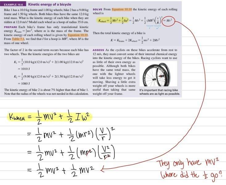

How did they get mv^2? Where did the 1/2 go? I tried working out the equation below the question and I ended up getting (1/2)mv^2.
Look at the image to see. It's the rotational kinetic energy formula.
It's in part 1
It's in part 1
Their mv2 came from combining ½mv2 + ½mv2
