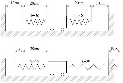

A mass of 0.1 kg has 2 springs of length 20 cm attached to each side, like in the drawing. they are loose. one has a constant of 50 [N/m] and the other 30. The system is between 2 walls 10 cm distant from each spring.
At the second stage the springs are tied each to the nearest wall. the system stabilizes and the springs have different length. what is the length of each spring.
This is the first part of a question, but i got stuck.
Spring force: $$F=kx$$
At first i marked with x the distance the k=50 spring stretches. of course it is tied to the wall but i drew it apart in order to clarify. in this notation the k=30 spring stretches 0.1 meter + (0.1-x):
##50x=30\left[ 0.1+\left( 0.1-x \right) \right] \Rightarrow x=0.075##

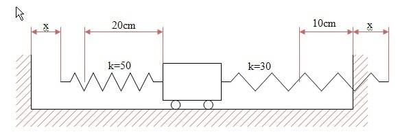

And it is correct. but then i used an other notation, like in the second drawing, where x is the distance from the wall and tried:
##50(0.1-x)=30(0.1+x)##
And it's wrong, i can't understand why

[itex]x[/itex] is the distance from the left wall to what? Your diagrams are not exactly clear.
and tried:
You will get that equation by taking [itex]x[/itex] to be the displacement of the mass from its initial position, with positive [itex]x[/itex] in the direction of the spring with constant 50 N/m.
It is best to solve problems symbolically, and to only plug in numbers at the very end. That way you can see at each step what is going on.
Try doing that with your second method.
Yes, this is another way to look at my second method. your x, the displacement of the mass, is equal to my x, the distance to the wall. of course the mass moves, but to me it was clearer to visualize with the mass fixed.
So, this equation:
Describes the mass's displacement x as you said but it's wrong.

Solving that gives [itex]80x = 2[/itex], so [itex]x = 1/40 = 0.025[/itex]. The extension in the spring with constant 50 is then [itex]0.1 - x = 0.075[/itex], in agreement with your first method.
