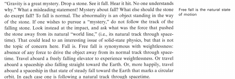

May I suggest the following paragraph from the Gravitation by Misner, Thorne, and Wheeler:
