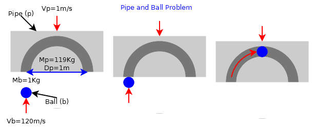

I am making a physics simulator and this problem is tricky. You have two freely moving objects with known masses and velocities in a frictionless environment. The first object is a ball and the second is a pipe. They are moving toward each other. I need to know what formulas are used to simulate the changes in their vectors. I attached an image for this problem.

I am making a simulator in java to show what happens when a ball rounds an 180 degree arc. This sounds easy at first but the ball and arc can move freely in space with zero friction. My simulator breaks down each frame by a specific distance traveled then each time-frame by the length of time it takes for a specific action. I need to find the formulas to determine the final velocities and travel directions for the ball and the arc per frame (distance). I attached a picture with the specifics. I know at first glance this should be a simple two-dimensional elastic collision problem.

I assume the ball is given some initial velocity, goes around inside the tube and comes out the other end. How do you calculate the new velocity vector given the old velocity vector at each step in your simulation? The conservation laws apply here but they can only give you the final quantities.
To get the final quantities using a step by step method, you need to figure out how much velocity to add to the old velocity in order to get the new velocity at each step. The amount of velocity ##\Delta \vec{v}## that you add per step is the acceleration of the ball. Whatever ##\Delta \vec{v}## you add to the ball must be accompanied by another ##\Delta \vec{v}## added to the tube. Of course, this addition must be consistent with momentum conservation in two dimensions at each step by ensuring that ##m_{ball}\Delta \vec{v}_{ball}+m_{tube}\Delta \vec{v}_{tube}=0##.
Don't forget that that the acceleration of the ball is centripetal, i.e. it points towards the center of the arc, wherever that is at each step, and has magnitude ##v_{ball}^2/R##.

The ball and arc both have opposing initial velocities. If the ball where to only hit the apex of the arc then this problem would be much easier. Each frame of animation in my simulation deals with an exact distance that is traveled between frames. So a total travel would be 'X' frames of 'S' distances with time between frames being the only thing that changes based on final velocity. I simplified this part of the simulation to deal with length segments around the arc instead of a continuous curve. I have been testing a set of formulas for the changes in X and Y velocities of the ball and the arc at each step of the simulation. I haven't coded them yet though, just put them in a spreadsheet. I haven't quite solved this one yet.
It's still easy if all you care about is the final velocities of the masses. The only thing you have to keep in mind is that the center of mass travels in a straight line which means that the ball moves gradually to the right while the arc moves gradually to the left. In the end though the final velocities would be the same as in the case where the ball hits the apex of the arc.

When the ball is at the apex then the centrifugal force of the ball is in direct opposition to the movement of the arc PY=mv⋅SIN(Θ), PX=mv⋅COS(Θ). Unless I am wrong, the total kinetic energy transferable would be KT=K/√2 since the two are traveling toward each other.
Surely the condition shown in far rhs image can never be ? The arc shaped pipe will have been tipping over in the clockwise direction continuously since the ball first entered it ?
I suppose it would depend on the difference in kinetic energy. If the pipe was extremely massive then the ball would round the bend and not lose much of any speed. If the pipe had almost no mass then the ball would never round the bend and send pipe spinning off into oblivion. At any rate, the formulas are the important part. I just added numbers to give people something to work with.

Often, when constraint forces are very difficult to calculate, it's easier to use a Lagrangian approach with generalized coordinates. Consider a parameter ##\theta## which is the angle of the ball relative to the middle of the bottom face of the pipe block while the ball is in the pipe are in contact. It goes from 0 to pi.
Energy, momentum, and angular momentum are conserved. Assuming there is no deformation, all the energy is kinetic energy, so you have:
##T=(1/2)*m_b*v_b^2 + (1/2)*m_p*v_{cp}^2 + (1/2)*I_p*w_p^2##
The second and third terms are the translational and angular kinetic energy of the pipe block. We neglect the angular kinetic energy of the ball.

I agree. The equations of motion I got are not pretty. I figured that they can be converted to difference equations and solved using a step-by-step procedure that is good enough for simulation purposes.

If there is no friction between pipe and ball, and the pipe cannot rotate, then this is equivalent to an elastic collision:

Any real collision has some non-zero duration, but for many applications only the final velocities are of interest, not what happens during the collision.
