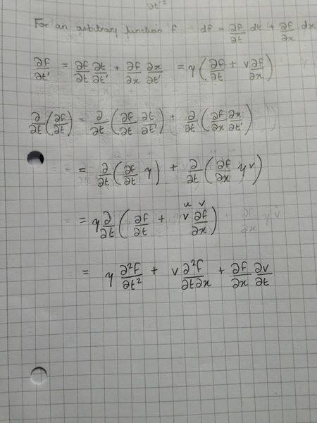

I get zero...
Well ok I get this, but it seems wrong
gamma((d2f/dt'dt)+ V(d2f/dt'dx))
Handwritten derivation on grid paper applying the chain rule to a function f: partial f over partial t' expanded into partial f over partial t and partial f over partial x terms, then differentiated again with respect to t' giving a second-order expression with mixed partial derivatives and a term involving the derivative of v.
, Hey, see the attachment for what I got... Ignore the previous post...
I am really struggling with this :-(... I can't see what I am meant to be doing to get to the answer.. Like I can't see the path

You need a little practice doing coordinate transformations. Check this out:
[tex]\frac{\partial^2 f}{\partial t'^2}=γ(\frac{\partial^2 f}{\partial t\partial t'}+v\frac{\partial^2 f}{\partial x\partial t'})[/tex]
Ahh your kidding me right? I had that originally a you can see from my previous post
Anyways, given that I don't know what f is.. I'm not sure how to proceed

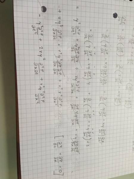

f is just an arbitrary function of the primed and/or the unprimed variables. Just substitute phi for f. Remember that, at a given location in 4D space time, phi prime is the same as phi.
Hey,
Yeah I did that and substituted it in and got this
Handwritten derivation on grid paper applying the chain rule to transform partial derivatives of a function f from (x, t) to primed coordinates, with the Lorentz factor gamma and velocity v appearing in the second-derivative expressions.
I'm confused as to where and when I'd do a Taylor expansion? Do I just Taylor expand the Lorentz factor? But that seems a bit wrong...
smallgirl said:
Hey,
Yeah I did that and substituted it in and got this View attachment 61516
This is not what I got. Check the math. I got:
[tex]\frac{\partial^2 \phi}{\partial t'^2}=γ^2\left(\frac{\partial ^2 \phi}{\partial t^2}+2v\frac{\partial^2 \phi}{\partial x\partial t}+v^2\frac{\partial^2 \phi}{\partial x^2}\right)[/tex]

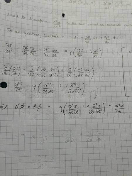

Photo of handwritten derivation on grid paper, rotated, showing operator equations with partial derivatives in x, y, z and t, including terms with velocity v and a bracketed Lorentz-type expression.
Hey so I figured the maths out and arrived at what you have... Not sure what I'm meant to do now... I'm utterly lost...
Hmm maybe taylor expand gamma and then substitute in?
OK. You're almost done. Now you substitute this back into the equation relating the Δ's, and combine the two terms containing the second partials with respect to t, by reducing them to a common denominator. It looks like your final result is going to have a linear term in v/c, which apparently the original problem statement omitted. At this point, you can approximate the γ's by 1. You will have 3 terms on the rhs, one with a factor of v/c and two with factors of (v/c)2. In any event, the presence of the linear term in v/c will not change the main conclusion from the problem statement.

I've yet to go through your solution and see how that works out for me, however this is what I came up with( see attachment)... Not sure how accurate the logic is...either way, I am soooo grateful for your help, so thank you soooo much!
I have no answer to check with...
Handwritten derivation on squared grid paper applying the chain rule to a wave operator under a Lorentz transformation, ending with an expression for F as a function of t, x, y, z.

I looked through your last hand-written development, and there are algebra errors in the last two lines (especially if you correctly include c in these relations).
