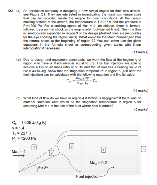

What is the giveaway the region 4 is rayleigh flow
from given question i can see there is an oblique shock then normal shock then isentropic expansion. what follows is rayleigh flow. what tells me that from question attached
answering part c
could someone explain each region of diagram. thanks. I've got parts a and b correct
FannoFlow88 said:
Homework Statement:: What is the giveaway the region 4 is rayleigh flow
Relevant Equations:: from given question i can see there is an oblique shock then normal shock then isentropic expansion. what follows is rayleigh flow. what tells me that from question attached
According to these links, the lack of friction and the heat from combustion in region 4 should be the giveaway:
https://en.wikipedia.org/wiki/Rayleigh_flow
"Rayleigh flow refers to frictionless, non-adiabatic flow through a constant area duct where the effect of heat addition or rejection is considered."
https://en.wikipedia.org/wiki/Fanno_flow
"Fanno flow is the adiabatic flow through a constant area duct where the effect of friction is considered."
