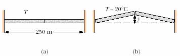

Two concrete spans of a L = 270 m long bridge are placed end to end so that no room is allowed for expansion (Fig. P10.55a). If the temperature increases by T = 21.0°C, what is the height y to which the spans rise when they buckle (Fig. P10.55b)
change in L/L= average coefficient of expansion(change in T)
average coefficient of concrete= 12 X 10^-6
I tried doing
change in L/270= 12 X 10^-6 (21)
I got change in L, and now I don't know what to do. HELP
Once you work out how much the concrete expands by its really just a case of pythagoras theorem to work out the height they raise when they buckle.

If you assume that the break is in the middle as the picture points out, you have the original length and the new length which is the original plus the change in length. Divide each number in half and that will give you the hypotenuse and the base sides of a right triangle. You need to find the opposite side's length, which I am assuming you can do.

L= 270
change in L/270= 12 X 10^-6 (21)= 0.06804
270+0.06804= 270.06804
270/2= 135
270.06804/2= 135.03402
now according to u I should do pythagorean theorum, which I did and got 190.9
thats not right
I got it though finally, when I do L/2, which is 270/2= 135, take the change in L, which is .06804
135 X .06804 and take its square root, I get 3.03, which is the answer

Your Pythagorean calculation is incorrect. You added the square of the long leg (135) to the square of the hypotenuse. You need to subtract the square of the long leg from the square of the hypotenuse and take the square root to find the short leg.
