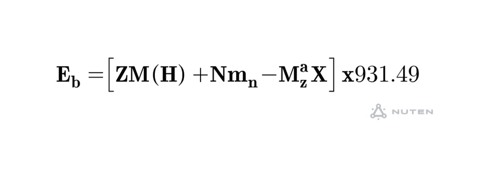

Equation for nuclear binding energy: Eb = [ZM(H) + Nm_n − M^a_z X] x 931.49, with a Nuten logo below the right side.
