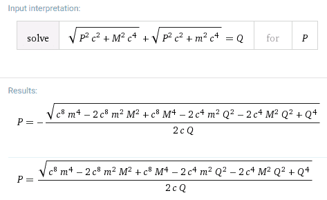

Are you sure? I have 2 unknowns. By conservation of momentum I have
mp vp = ∂v mv vv
But i don't know vp or vv. But wait! Could I maybe say:
P=momentum
Pp = -Pv = P , and then say
Q=Tp + Tv
Q=sqrt(P2c2 + mp2c4) + sqrt(P2c2 + mv2c4) = .782MeV
and then solve for P!? which i can then use to find just the kinetic energy of the proton!? :D

Actually, I am getting THIS so i want to convert my 0.782MeV into 8.395x10^-4 amu*c2 by dividing by 931.5. If i do this, my units of momentum would be mass and speed, which is good, right? Or do you think it changes things with all the exponents to the 8th, 4th, and 2nd mixed in?

Well wolfram is saying P equals a momentum of 4.89x1036 amu*(m/s)2 = 8.13x109 kg*(m/s)2 which does not seem reasonable because the proton is heavy and should not act relativistic... But i could be wrong about that. I am not very certain of these things either since I am in a class 2 semesters ahead of all the other classes I am in and i skipped the pre-requisites lol.
You are right, your equation
##\Sigma \sqrt{(p_i c)^2+(m_i c^2)^2}##
is correct, but in this case, there are only 2 particles, and their momentums must be equal so my equation that i asked wolfram to solve actually fits your generalized equation, and should be correct too.
But its 4:30am here so I am just about done with this problem anyway lol. Unless you have a breakthrough epiphany type of solution idea then i think i should be fine haha. I have the concept down much better now and I owe it all to you for helping me get to the realization of
I still don't see that. What follows is for case (b).
I am saying
##m_Nc^2=\sqrt{(pc)^2+(m_Pc^2)^2}+\sqrt{(pc)^2+(m_ec^2)^2}+m_{\nu}c^2##
Not sure because I thought it was unclear whether neutrinos have mass.
Edit:
Since pc is to be found, we can write that in the form ##E=\sqrt{x+a}+\sqrt{x+b}##.
From that I get ##4E^2x=E^4-2E^2(a+b)+(a-b)^2##.

Brilliant! Your math checks out

You're right, I found that out. I already got my answers and I am confident in them. Thank you very much :)
Summary for future readers looking for the guidance more consice:
Using these equations in the order they are written would be helpful for both parts but part A specifically
##Q=({\Delta}m)c^2 = .782##MeV
##Q = E_n = E_p + E_{e^-} + E_{\nu}##
##Q = E = \sqrt{x+a} + \sqrt{x+b} + d##
where ##x=(Pc)^2##, ##a=(m_pc^2)^2##, ##b=(m_{\nu}c^2)^2=0##, ##d=(m_{e^-}c^2)^2=.5114##MeV
The electron has only rest mass energy because its kinetic energy is said to be zero. ##Pc## is the same for both the proton and the neutrino because momentum must be conserved and equal if the electron has zero momentum.
Finally,
##(Pc)^2 = x = \frac{(a-d^2+2dE-E^2)^2}{4(d-E)^2}## and using momentum, one can find kinetic energy
All credit goes to haruspex and to PeroK.
