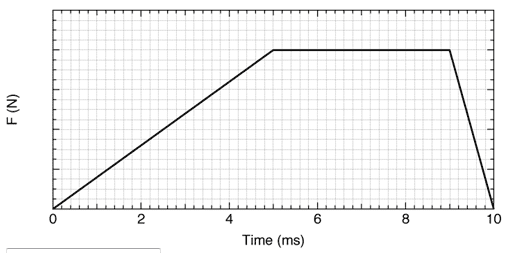

The Figure shows an approximate representation of the contact force versus time during the collision of a 42-g tennis ball with a wall. The initial velocity of the ball is 35 m/s perpendicular to the wall; it rebounds with the same speed, also perpendicular to the wall. What is the maximum value of the contact force during the collision?
P = mv
I know P = 35 (42/1000) = 1.47 N*m
What is next step? Thank you!
You're trying to find the value of the maximum force, which is the value where the graph flattens out.
Solve for J, using the same equation
Po + J = Pf
J is the area of the figure.

but in the problem, there are no number is given on vertical axis!
That's what the problem asks you to figure out :cool:
so the 1st Area is 0.5 * 0.005 * F
2nd Area is 0.5 * 0.004 * F
3rd Area is 0.5 * 0.001 * F
So I add all them up: 0.005F, then 1.47 - 0.005F = (42/1000)vf
now I have 2 unknown ?

You did a good job with the 0.005F. What does 0.005F equal? (Hint: read the previous posts)
0.005 F = mv right?
Hint #2: It's in my first response :wink:
0.005 F = Pf - P(o) = > 0.005 F = m [vf - v(o)], right?

The maximum force is easy to locate on the graph but the problem is we do not know how the vertical axis is calibrated - ie how many Newtons per square. You have to work that out from the information given.
What is the total change in momentum? How is that related to the total impulse? What aspect of the graph represents the total impulse? How does that enable you to determine the vertical scale of the graph?

but 0.005 F = (42/1000) * 35 => F = 294 N => Wrong!
This looks right. I deleted my other post because I quoted the wrong response.
Remember that 0.005F would be negative in this case because it's a force opposite the motion.
but what is vf ?
quoted directly from the problem
Oh! I see! So -0.005F = -2 v m => F = 588 N ?
Yep, that's the answer I have.
588 N = incorrect :(
I went back to your calculation of your area:2nd Area is 0.5 * 0.004 * FThat 0.5 shouldn't be there.

-5*10^-9 F = -2 m v ?
...no.
The area calculation is correct except for the tiny mistake I pointed out.
GOT IT! Thanks for your patience again! ;)
