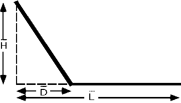

A frictionless track is to be built as shown, with L=4.60m and H=4.80m. In order to get the cart to slide from the top to the end of the track in the minimum time, how long should the distance D be? Assume that the speed of the cart on the horizontal surface is the same as at the bottom of the ramp.
Energy can easily get you the velocity over the flat L-D stretch of the ramp. So that time is just L-D over that velocity. You want to add that to the ramp time. Here you'll just have to use kinematics. Figure out the component of acceleration down the ramp and use that to get the time to descend the ramp. Now add the two times and find a minimum by taking a derivative with respect to D.

It's moving at a CONSTANT velocity over the flat part of the track. time=distance/velocity.

now for the time on the ramp. the distance is (H^2 + D^2)^.5. can this distance be thought of as the displacement?
It can not only be thought of as the displacement, it IS the displacement. This part of the problem is a simple inclined plane problem. It's not rocket science.

Touche. I can get abrupt and impatient this time of night when these things drag out, apologies. You can handle this. Compute the acceleration down the incline and use the displacement we both agree on, and find the time.
