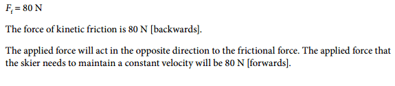

The lesson that I am doing uses 'backwards' and 'forwards' to identify the direction of the motion. When i say the frictional force is acting backwards, i mean it is opposing the applied force. But since the acceleration is negative in this case, i don't know whether to make the direction forward or backward. Would it also make sense to say:
-6.1 m/s^2 [forward] , the acceleration is negative because the puck is slowing down, but it is also slowing down in the same direction 'forward'
here is what the lesson shows:
Based on that example, the bracketed word is not a comment, so your answer would be either "6.1 m/s [backwards]" or "-6.1 m/s [forwards]".
