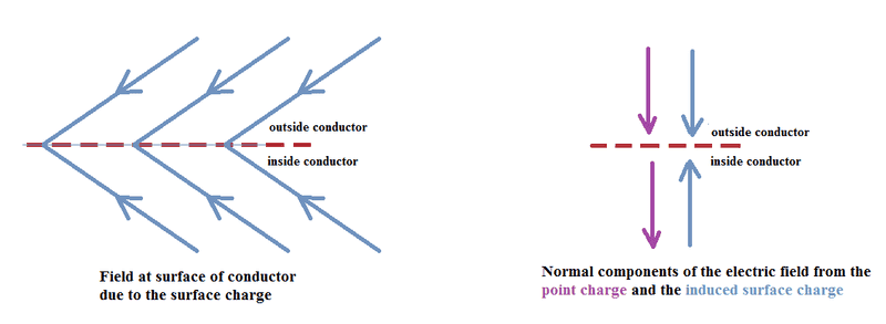

There will be a nonuniform, induced negative surface charge density on the surface of the conducting slab. At a point just outside or inside the conductor, there will be an electric field produced by all of the surface charge. This electric field will have both normal and radial components.
Because the surface is a flat plane, the field produced by the surface charge must be "mirror symmetric" with respect to the plane as shown in the left figure of the attachment. Thus the normal component just inside the conductor will be equal in magnitude but opposite in direction of the normal component just outside.
Now add in the normal component of the field due to the point charge as shown in the right figure. The normal component of this field is continuous as you pass through the surface of the conductor.
We know that the total field inside the conductor must be zero. So, that tells us something about the magnitudes of the normal components of the two fields inside the conductor. Then we can make a conclusion about the magnitudes of the normal components just outside the conductor.

TSny,
Thank you very much! I finally have my head around the solution. You're absolutely right(as I see it, now) that the view of fields nearest to the conductor can be considered through their analogues within the slab. And furthermore, the normal components are related through the need to have the electric field identically zero within.
Once again, it's a very cogent elucidation! (and I am especially beholden for the useful illustrations you provided).
As an aside, I had calculated the radial components at θ = 0 (which would merely reproduce the normal direction) -- reached the same coefficients, and thus, made sure that the definitions thereof are consistent(as one would expect).
