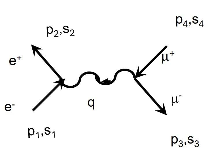

I have seen many tutorials that provide steps how to transcribe a Feynman diagram into algebra, for instance [here]:
However, I have never seen the final line of the calculation converted into a real number. What are the steps to get from the algebra equations transcribed using the Feynman diagram, into a final concrete (eg 0.1726341) probability number for this interaction to happen?

The probability of the diagram you have written down is calculable. The answer is 0.000000.
Momentum and energy are not conserved.

Such a diagram is not a process at all. It's the leading term in an infinite series which represents the process. As such the mathematical representation/value of that diagram does not give what you want.
Interpreting Feynman diagrams as processes is something which only happens in popular science. Or at least: that ought to be.

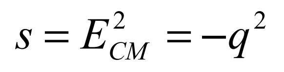

Thank you. I realize many factors must be taken into account to get the final probability. It's just easier usually for me to work backward to understand the answer for the first time. From @Spinnor [here],

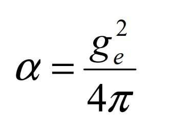

where s and alpha have been previously defined as:
and

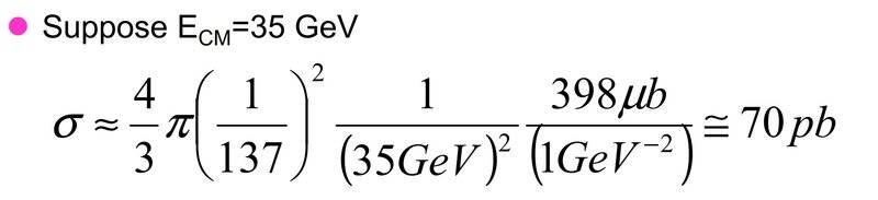

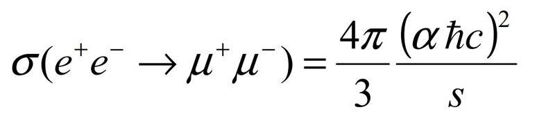

which are jointly used to derive the final numerical result:
I'm unclear how the 1/137 and 398 values above were obtained?
1. Is g_e some constant value that is readable from a table, giving us the 1/137?
2. How does hc equals to 398/1?
It may be easier for you, but it is much, much harder for us. @Demystifier is right - you are asking us essentially to write a textbook for you, only out of order. Further, I don't think it's even true: thinking you understand is not the same as actually understanding.
To the specific question, the equation in slide 35 is the same as the one on slide 33, only with some numbers plugged in. You can't understand Slide 35 without understanding Slide 33, and this goes all the way back.

1. ##\alpha = 1/137##is the famous fine structure constant.
2. ##(\hbar c)^2 = (197.3)^2 = 3.89## MeV. I presume 398 is a typo and involves decimal places conversion from the ##\mu b## units.
The result states that the probability of muon pair production from electron annihilation depends only on the momentum/energy E of the incoming electrons, proportional to a universally applicable coupling constant.
ad 1. ##\alpha=1/137## is the usual back-of-the-envelope approximation of the fine structure constant. It's much more precisely known today. See, e.g., the pdg webpage for precise values of the constants:
https://pdg.lbl.gov/
ad 2. It is utmost important in physics to use correct units; ##\hbar c \simeq 197.3 \; \text{MeV} \, \text{fm}##. Indeed ##\hbar## as the dimension of an action, i.e., of ##\text{energy} \times \text{time}## and ##c## the dimension of a velocity, i.e., ##\text{length}/\text{time}## and thus ##\hbar c## has dimensions ##\text{energy} \times \text{length}## and convenient units in particle and nuclear physics are ##\text{MeV}## and ##\text{fm}##. So a correct statement is ##(\hbar c)^2 \simeq 38927.29 \text{MeV}^2 \text{fm}^2##.
