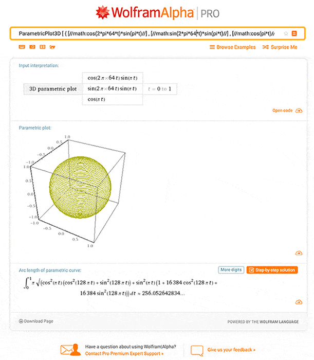

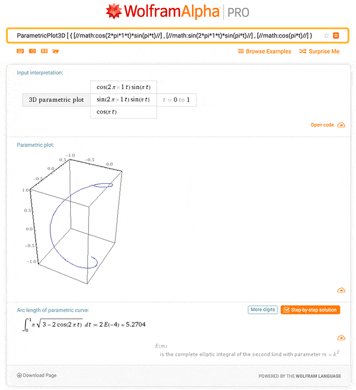

  • #35
PeterDonis said:
Because it could have a topology like a 3-torus, which would give it a finite 3-volume. Having a Euclidean metric does not require that the space have the same topology as Euclidean 3-space.
Is it necessary or only convenient to reference a 3-space?
I define an arc with n=arbitrarily high # turns. I make a straight line from point t=0 to point t=1. Next I bisect line t=0, t=1 creating a point A. The vector is created first by a line from point A, through the referenced spiral point B to point C, a point in space. Points in space are referenced as Vector: t=0.14563... Distance: 686,739,974.97969...km
  • #36
If we're talking about the universe, then yes, since spatial slices of the universe are 3-spaces.
I don't know what you're trying to get at with the arcs.
