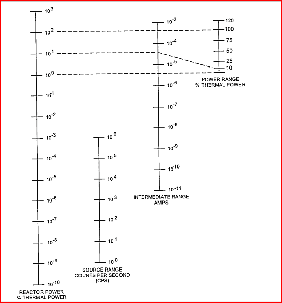

hello all, I am trying to determine what the percentage of reactor power will be at each power level range measured by each detector (i.e Source, Intermediate and Power range). All I can seem to find is info in the CPS rate not percent reactor power.

This may be close. It indicatesthe source range goes from a few cps (usually a min of 2 cps) to about 1M cps (M = million), intermediate range from 0 power (100k to 1 M cps), but increasing counts to 1% to 10% reactor power, and power range overlaps up to about 10%, and then is all the way to 100%.

http://www4.ncsu.edu/~doster/NE405/Manuals/BWR6GeneralDescription.pdf
Go to figure 6-3 on page 6-6, this shows the overlap between SRM, IRM, APRM, and also the relationship between neutron counts and rough % power.
The rule of thumb that BWR licensed operators are taught, is that the IRMs, on range 10 at 100%, are about 40% reactor power. Every down range is a factor of sqrt(10), or in other words, every 2 ranges is 10x). So 100% flux on range 8 = 4% power, and 100% flux on range 6 = 0.4% power. 100% flux on range 4 = 0.04% power. etc
This is a very rough estimate, but gives a relative range. At any given point in time, your 8 IRMs for a BWR can be as much as 2 ranges apart, based on local core power, burnup of the IRM detector, and calibration/compensator settings.
The actual % power or counts per second doesn't matter as much in startup and low power operation. Your focus is more on maintaining reactor power steady while you are heating up and bringing steam loads online.
Once you are in Mode 1 (Power Operation), your SRMs and IRMs don't really matter or count anymore. After a scram, your IRMs are only used to follow the power decrease and to act as a backup method to determine the core is shut down. SRM indications aren't really useful except during pull to critical and core alterations, however they also provide period indications which are useful during all power operations as they are the first indicator of something going snakey in the reactor.

Was i surprised to find this old document. It's a "how it works" for Westinghouse PWR.
http://pbadupws.nrc.gov/docs/ML0230/ML023040050.pdf
Three ovelapping instruments cover the reactor from zero to 200% power.
They use neutron detectors located a foot or two or three outside the reactor vessel in the ventilating space.
two are logarithmic , one is linear
here's their approximate overlap
Source range indicates counts from a proportional counter tube, ie individual neutrons that strike the detector, from about 1cps to 1 million cps on a logarithmic counts per second meter scale
Intemediate range indicates current from a small compensated ion chamber just above the source range counter. It indicates DC current not counts, because when count rate gets high enough the pulses run together and become a DC current. When intermediate range is indicating we turn off high voltage to source range so as to not saturate its detector.
intermediate range indicates current from approximately 10-11 amps to a milliamp on a logarithmic ammeter scale. It reads about a milliamp at full power but with its 8 decade log scale it's not accurate enough for fine control of power.
Power range is linear and indicates current from a large ion chamber , calibrated to indicate reactor power on a linear scale from 0 to 120% .
The power range instrument is capable of accurately reporting reactor power to 200% , two special fast response recorders are provided in the control board for "just in case" . Automatic trips will drop the rods long before it gets there.
Detailed description at that link up above
and here's the approximate overlap from its page 28
be aware this chart is approximate, for teaching purposes only.
But it i think answers your question for Westinghouse PWR's.
Exact overlap depends on the arrangement of concrete surrounding the reactor and how far outside the vessel each individual detector is positioned.
So do not expect to find any plant's actual numbers in exact agreement with it. They might differ by nearly a decade.
