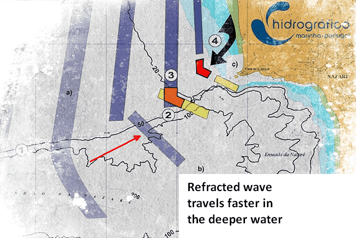

What is the relationship between refraction and giant waves in Nazaré?
In summary, a storm in the open sea causes the waves to break, and the breaking of the waves creates the energy that starts the Nazaré waves.
veraamorim
The waves of Nazaré start because of a storm in the open sea. The winds cause a disturbance on the surface, transformed into energy. When the depth is great, the propagation of the waves (energy) is practically constant. As they approach the coast, therefore in shallower places, the wave length decreases, but its height increases.
When the wave speed is higher at the crest than at the pit, the wave breaks. In the case of the Nazaré wave, another factor is important. A promontory divides the beach in two. On the left side, the seabed is normal, that is, the depth gradient decreases steadily when approaching land. But, on the right side of the promontory, there is a canyon, a kind of underwater gorge, the deepest of the entire European coast. https://marsemfim.com.br/formacao-da-onda-de-nazare/Acesso em 11/02/2021

The way in which the Nazerre wave is created is explained in https://www.surfertoday.com/surfing/the-mechanics-of-the-nazare-canyon-wave where the critical importance of the underwater canyon is discussed, as is how the sea floor profile causes the wave to refract. Other factors also contribute.
The incoming wave effectively splits into two. One part continues forward. The other part is traveling in deeper water so travels faster and is refracted and directed towards the first part.
When the two waves meet, their wave heights add producing a wave equal, in principle, to the sum of their individual heights when they are in perfect phase.
Any wave approaching a shoaling sea bottom will rise in height because a shallow water wave travels slower where the depth is less. The front encounters the shallow and slows while the back is still in deeper water and continues at the original speed, causing the water to pile up. A shallow water wave is one where the wave length is longer than the water depth.
This is precisely what happens with a tsunami and, in fact, tsunami is Japanese for "harbour wave" as the waves are only seen close to the shore. A tsunami is all but imperceptible in the deep ocean where it is traveling at, say, 500 km per hour, but is only 1 foot high. As its wave length is so long - say 500 km - when a complete wave passes by, a boat is lifted by 6 inches in 15 minutes, then falls by one foot in 30 minutes, then is lifted by 6 inches in 15 minutes, something completely imperceptible to those aboard. It is only when the wave slows on reaching a shoaling shore that its height builds. The standard tactic for a boat in harbour is to head out to the open sea if a tsunami is imminent.
Different sea floor profiles give different build heights which is why one area may be devastated but a nearby area is hardly affected.
