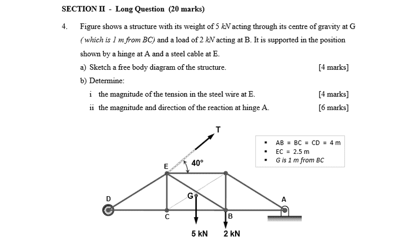

In summary, the given problem involves a structure with a hinge at point A and the ability to roll over the supporting surface at point D to compensate for expansion. The equilibrium conditions for the structure are that the net forces in the x and y directions are equal to 0, and the total moment is also equal to 0. The question is whether or not there should be a force present at point D, and it is suggested to assume there is no force and that point D may be a pulley instead of a support.

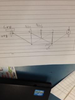

I need help with the body diagrem
The D circle thing is what? is that a roller?
Yes, I also think so. The structure hinges at A and in order to compensate for its expansion it can roll over the supporting surface at D. The cable is there to raise it.
Did i draw correctly?
It seems so,yes. I am also not sure if there should be a force at D since it seems you would not be able to solve it if there is a force present at that point.
I think you should assume there is no force at D. Maybe it is not a bridge and it is a pulley at end D.
That is how I see it also. No support at D.
