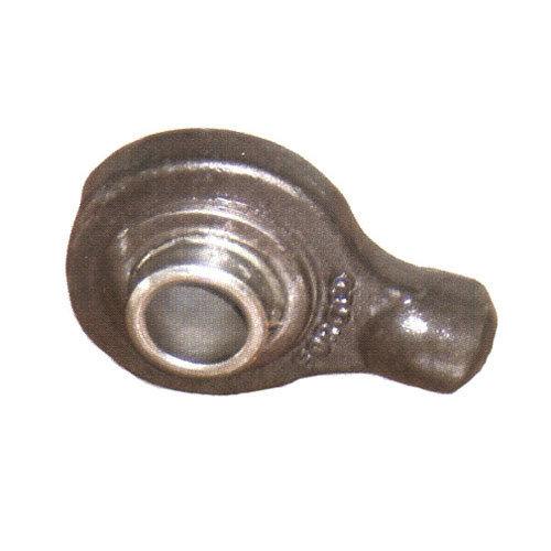

Being not myself a mechanical engineer, my intuition is to use something like this
on your F3 element
clamp it between your elements F1 and F2 and let the swivel handle mis-alignment that's what it is for.
Now you've got rid of bending in your bolt and replaced it with shear.
I'll leave it to the genuine mechanicals to advise on whether that's a good idea.
Shown is a "top link end" for a tractor, about $5 at farm supply stores.
They come in several sizes. This one is cat1 having a 3/4 inch hole.
I haven't found load ratings for the agricultural equipment parts. 25000 pounds is substantial so be real careful with this project

Keeping in mind that ordinary steel oughtn't be loaded near(maybe 2/3?) its yield point of about 36,000 psi you need to make sure your 25,000 lb pull is not imposed across less than one square inch of steel.
How much cross sectional area is left in those 3/8 bars after drilling your half inch hole?
A 3/8 inch square is only 9/64 square inch so should not be subjected to more than 9/64 X 2/3 X 36,000 = 3375 lbs of pull.
And from that manufacturer's site , for 25,000 lbs of pull i'd pick his 3/4 inch bore rod end.
I hope this ramble makes clear why there are so many raised eyebrows among previous posters.
The sketch looks to me weak at the boltholes.
Don't get hurt.
