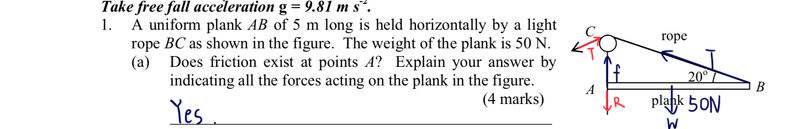

I want to know whether I draw the free body diagram correctly? Thank you.
T = tension
f = friction
W = gravitational force
I think there’s something missing, please help.
The forces that you have drawn look good. But you have left out a force. See if you can spot the missing force.
Also, you will want to explain from your diagram why there must be a friction force at point A.

Is it the normal reaction missing?
Yes. To be sure that you are thinking correctly, I would need to see where you place the force and the direction of the force.
R stands for the normal reaction. Is it correct? also, I’ve added a new T for tension. Is the T in red needed?
The reaction force R should be a normal force acting normal to the wall. I assume there is a wall.
The red tension force is not a force acting on the plank. So, it would not be included in a free-body diagram of the plank.

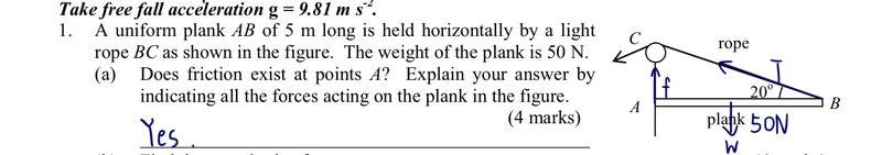

So I do draw the R correctly?
No.
My interpretation of the diagram is that the left end of the plank is up against something like a wall. The wall exerts a force against the left end of the plank. This force from the wall has a component parallel to the wall (this is the friction force) and a component normal to the wall.
Looks very good. Can you use this diagram to explain why the friction force cannot be zero and why it must be in the upward direction?

Is it because ‘friction has to be there to balance the gravitational force W ’?
dorothy said:
Is it because ‘friction has to be there to balance the reaction force in order to stay at rest’?
No. The friction force is vertical while the reaction force is horizontal. Since they are in different directions they cannot balance each other.

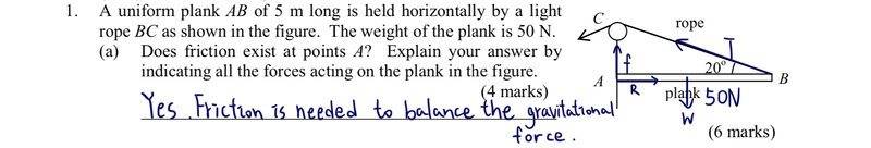

What are the basic conditions that the forces and the torques of the forces must obey in order for the plank to be in equilibrium?

I‘ve just change my thought , is it correct in this case?

Try picking point B as an origin for the torques.
(1) Does the tension force T produce any torque about B? If so, is the torque clockwise or counterclockwise?
(2) Does the weight W produce any torque about B? If so, is the torque clockwise or counterclockwise?
(3) Does the reaction force R produce any torque about B? If so, is the torque clockwise or counterclockwise?
Based on your answers to these three questions, can you argue that there must be a friction force at A and that the friction force must be upward?
1. Yes, clockwise
2. Yes, anti-clockwise
3. No
Ohhh is it because we need the moment due to f to balance with the moment due to W in order to reach the equilibrium?
dorothy said:
1. Yes, clockwise
3. No
You have the right idea :oldsmile:
But, the tension force T does not produce any torque about the origin at B. Can you see why?
This is important in order to be able to logically deduce that there must be an upward friction force.
