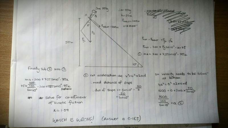

Sam, whose mass is 75kg takes off down a 50m high, 10° slope on his jet powered skis. The skis have a thrust of 200N Sam's speed at the bottom of the slope is 40m/s. What is the skis co-effecient of kinetic friction with the ice?
Thought originally to use conservation of energy at top and bottom, then calculate energy loss, then find distance of slope using trigonometry thus allowing me to use w=fxd to find the frictional force acting on skis, then use Fk=μxmass, to co-effecient of kinetic friction, but soon noticed he gained energy down the slope due to his thrust! stuck??
The thrust does work on Sam doesn't it?
So you could use conservation of energy or kinematics for this.
Draw a diagram. Show the forces on the skier. Then write down the kinematics equations.
Yes, the thurst does work, and I'm still not getting the correct answer, could someone please show me working??
Show your work so people can see where you are going wrong.
This is my working
in equation (1) - how do you work out the friction force?
You've multiplied the coefficient of friction by Sam's weight. Is the normal force equal to Sam's weight?
sorry yes that's my bad equation 1 should have (co-effecient of kinetic friction)xsams normal force which is not his weight 75 but rather 735xcos(10°) which now gives a co-effecient of 0.165 which is correct thank you i would never have seen that haha
