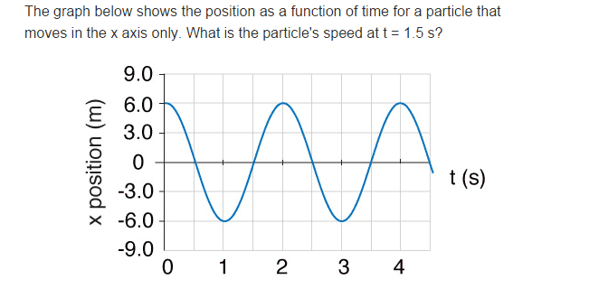

the particle is oscillating
so we know at 1.5 seconds, it is at the equilibrium point , where speed is highest. (the speeds are 0 at the highest and lowest points of the graph.)
we see that it goes from -6m to 6m, which is 12 meters in 1 second.
so is the answer 12 meters per second? since that is the highest it can go?

goonking said:
how do we find angular velocity?
The distance between two crests (high points) on the graph you provided is the amount of time it takes the mass to make a complete "revolution" (2π radians). Angular velocity is measured in radians per second... do you see where I am going with this?
yes, so it takes 2 seconds to do 1 rev.
so 2π radians in 2 secs , 1 radian per sec.
ω = 1 radian per sec.
A = 3 meters
and cos ω t = cos ((1r/s) (2 second)) = .99939
v = ω A cos ωt = 1 x 3 x .999 = 3 m/s
correct?

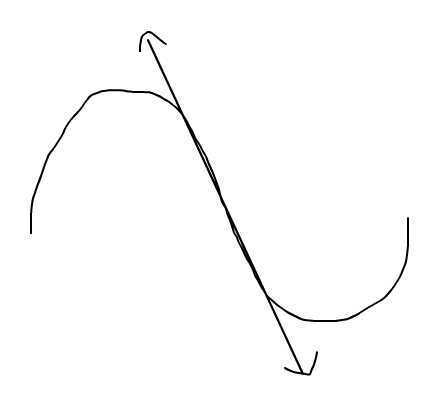

BvU said:
Draw a straight line with slope 3 m/s through the point (1.5s, 0 m) to check...
like this?
I have no idea how to confirm if that is suppose to correct or not.
No, I think BvU meant more like this
AlephNumbers said:
No, I think BvU meant more like thisView attachment 82264
i think he was trying to tell me my answer was wrong.
by the looks of it, my speed should be -3m/s instead of 3 m/s.
correct?
correct?
You just drew a tangent line at t = 2.5 instead of t = 1.5. At t = 2.5 the mass has a negative velocity. I believe BvU was just pointing out that you could draw a line tangent to the graph in order to check your answer.
AlephNumbers said:
No, you solved the problem. You just drew a tangent line at t = 2.5 instead of t = 1.5. At t = 2.5 the mass has a negative velocity. I believe BvU was just pointing out that you could draw a line tangent to the graph in order to check your answer.
oh wow, i meant to draw at 1.5 sec, not 2.5 sec, truly sorry!

A = 3 meters
correct?
Your value of A is not correct. It should be the maximum displacement. Also, make sure to use the correct value for ω.
sorry, let me fix that.
A = 6 meters.
ω = π r/s
correct?
A = 6 meters.
ω = π r/s
correct?
Looks good!
AlephNumbers said:
Looks good!
getting an answer to be 18.7 m/s.
if i want to check that, I would need to graph a line with slope 18.7?!
Yes. If you draw a line tangent to the graph at t = 1.5 you should get a line that has a slope of about 18.7

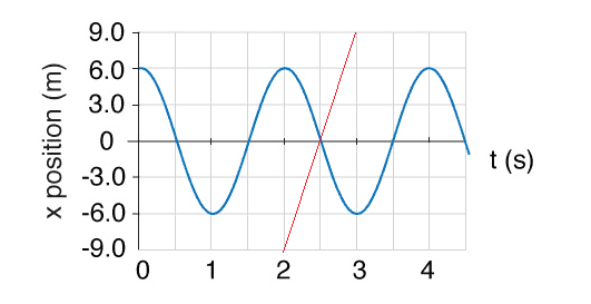

The line you drew is going through (2.5 s, 0 m) and has a slope 18 m/s.
Two out of three ain't bad, but here only one out of three values is as intended.
Coincidentally the 18 m/s is close to the correct answer of ##A\omega## where you found the wrong value for two out of two. That's not good at all. Fortunately, you already fixed the ##\omega = {2\pi\over 2} \ne 1##.
Fixing a factor of ##\pi## corrects one error in your answer. Guess what's wrong with the other...
Perhaps now you can draw a line that is going through (2.5 s, 0m) and has a slope 6##\pi## m/s to check that that is indeed the correct answer :smile: .
why does it have to be 2.5 s? don't you mean 1.5 s?
