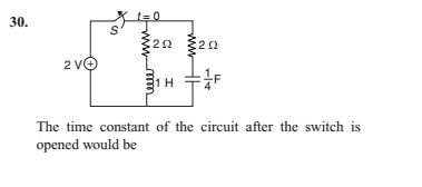

What is the Time Constant for an RLC Circuit?
9 replies · 12K views · last reply
jaus tail
613
48
Circuit schematic with a 2 V source and switch S at the top, two 2 Ω resistors in series with a 1 H inductor and a 1/4 F capacitor in parallel branches, with the switch marked t = 0. Caption: The time constant of the circuit after the switch is opened would be
I know for RL circuit T = L/R
For RC circuit it is RC
But how to go ahead for RLC circuit.
I calculated for RL as 1/4 = 0.25
And RC as 1
Then I added both time constant and got 1.25
Book answer is 0.5. How to solve this?
In solved examples they've used RL or RC circuits.

You need to stop using equations and start solving problems :)
Those equations are derived using certain methods. Things will almost never be exactly ideal, you need to learn how to derive the equations for yourself. You need to solve the differential equation, either using the time domain, or laplace to convert to the frequency domain (if you have learned that method, which actually makes these problems very easy to solve).

Converting to laplace I get
Circuit schematic labelled 30: a 2 V source with switch S at the top, two 2 ohm resistors, a 1 H inductor and a 1/4 F capacitor, with switch timing marked t = 0, and the caption asking for the time constant after the switch is opened.
The L becomes 1s. The C becomes 4/s
The resistances are in series so that becomes 4 ohm.
For t < 0 the current through inductor is 1A as it is short circuit.
The voltage across Capacitor is 2V
So now when switch is open
the inductor will be 1A current source and the capacitor will be 2V voltage source.
Voltage across capacitor is Ldi/dt + 4(current) = 1di/dt + 4i = 2V(c)

Now using kvl I get
2/s = (1/s) (4/s + 4 + 1s)
So 2 = 4/s + 4 + 1s
so 0 = 4/s + 2 + s
s2 + 2s + 4 = 0
Now how to proceed?
Book answer is 0.5
I'll do guess work
Laplace is V(s) = [ s^2 + 2s + 4 ] I(s)
So we do inverse laplace
I(s) = V(s) / (s^2 + 2s + 4)
Which is I(t) = V(t) e^[-(1+j1.732)t]
And time constant is when the e(raised to part) becomes e raised to 1
So (1 + j1.732)t = 1
t = inverse and inverse of this is 0.5
But I got this only cause answer was given. It's like I went backwards.

One problem. The initial inductor current should not be placed as a fixed, permanent source in your Laplace version of the circuit. That current is driven by the stored energy in the inductor and can be expected to dissipate through losses elsewhere in the circuit (resistors). Instead, it should be represented as a potential rise with the value ##I_oL##, where ##I_o## is the initial inductor current. No "s" is associated with this value as it's not a "real" source, but rather represents stored energy.
Things are a a bit different for the capacitor where you DO represent the initial charge with a "real" voltage source. Unlike current, charge is conserved. So for the capacitor you do use a source: ##V_o/s##.
Wikipedia has a reasonable treatment of Laplace transforms, and even provides a list of valid "transformed" circuit elements if you ever need to jog your memory.
How do I solve this question then? Book says for inductor Laplace is parallel current source divided by 's' n inductor is LS.
You have two choices when you convert the inductor to the s-domain. One places a current in parallel with the inductor, the other places a voltage in series with it. Since you're using KVL and want to write a loop equation of potential changes, the series voltage source is the way to go.

So now i get:
Hand-drawn s-domain circuit schematic with a voltage source V, series impedances labelled 2, 1s, 2 ohm, 4/s and 2/s, and a branch current I(s) marked.
I(s) = (1 + 2/s) / (1s + 2 + 2 + 4/s)
Which gives I(s) = (s + 2) / (s^2 + 4s + 4) = 1/(s + 2)
I(t) = e^(-2t) ---> By doing inverse laplace.
So time constant = 1/2 = 0.5
Got it. Thanks. But why did we take current [ I(s) ] and why not equation for V(s)?

You could have, but with only one loop, KVL is a one-equation simple approach. If you wish to solve via some V(s) instead, pick a reference node and another node in the circuit and write the KCL node equation.
