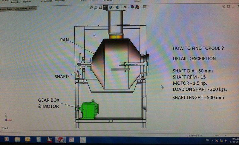

hello everyone,
I am a mechanical design engineer in pharmaceutical machine maker company. my question is about the torque of the shaft in my machine. In picture you can see the pan, in which the medicines are placed for drying and colour. the details is placed on picture. please tell me how to find torque in detail. Thank you in Advance.

The machine appears to show a rotating drum of some sort. The torque required to rotate it will depend to some extent on what's in the drum and how it moves. eg Will there be baffles that lift the contents and allow it to fall back down?

Yes there are four baffles in pan. the raw medicines put in the pan and rotates that drum on max. speed of 15 rpm.
The medicines weight is 50 kgs approximately. That machine is already made by my company hundreds times but no one knows the principles behind it.
I have just 1.5 years experience in this field so now i eager to know the calculations behind it.
I know that torque = F x r x sinθ. and all that but i don't know how to implement it.

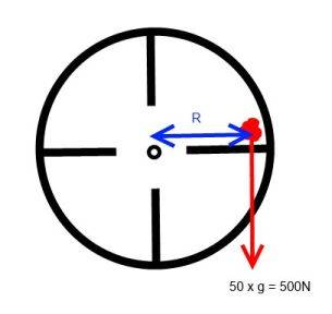

Try making a sketch drawing of a section through the drum. Perhaps assume all 50kg of the medicines have been lifted up on one baffle. Mark on the sketch F, r and θ.

Assumptions:
1) All 50kg of pills have been lifted up on a baffle until it reaches the horizontal position (θ = 90, Sinθ = 1)
2) The average distance of the pills from the centre is R = 750mm
Then using..
T = F*R*Sin(θ)
F = 50*g ≈ 500N
RSin(θ) = 0.75 * 1 = 0.75
gives
T = 500 * 0.75
= 375Nm
That's a crude estimate of the max torque required to turn the drum at a constant speed.
