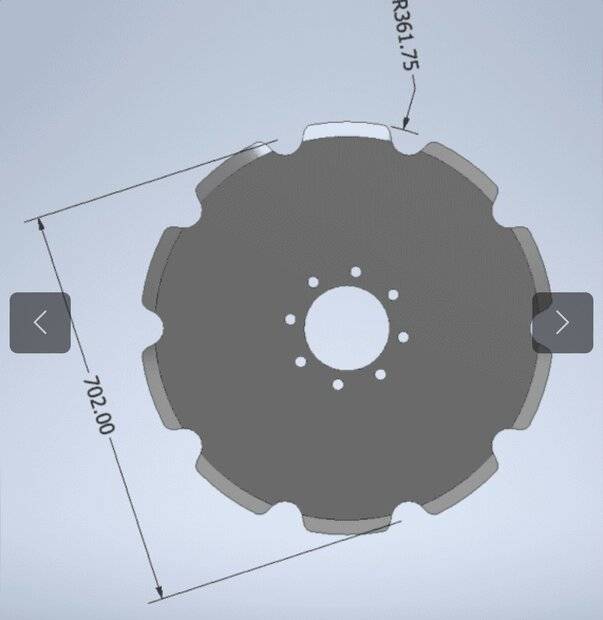

  • #31
Devin-M said:
Are you sure this part’s diameter is 70mm (2.76in) and not 70cm (27.5in or 2.2ft)?
Sorry I forgot to mention that I got the 70 mm from the shaft coming out the motor, the one you have shown is the sprocket that moves the conveyor belt, I did this because @jrmichler mentioned to measure the rpm coming OUT the motor
  • #32
jrmichler said:
That's the same that I get assuming 10 meters per minute and a 70 mm diameter conveyor drive roll. The next step is:
Another way to get the drive torque is to place the maximum load on the conveyor, wrap a long string around the drive roll, and pull the string using a spring scale. From the force to move the conveyor belt, and the radius of the drive roll (35 mm), you calculate the drive torque. Multiply the measured drive torque by a safety factor of 2 to 3 to get the design drive torque.
Now calculate the power to run the conveyor from the design drive torque and RPM (45.5 RPM). After the torque and power are well understood, then we can start to size the motor and reducer.

  • #33
If the sprocket that moves the conveyor is 702mm this changes everything.
  • #34
I have shows how the system goes from the motor, to a sprocket moving another sprocket with the same amount of teeth, which moves that bigger sprocket. I just want to know if the motor I have specified is enough for my use, if not I will need a bigger motor obviously.
The reason for my post is that I don't really understand how torques and forces are transferred in a sprocket system, when you say it changes everything what do you mean exactly?
  • #35
If the sprocket that moves the conveyor is 702mm instead of 70mm, the motor will need to turn 10x slower and output 10x as much torque.
  • #36
So logically speaking motor wouldn't be enough right? Since as I mentioned the 70 mm is the shaft coming out the motor which turns the sprocket that is 234 mm, the 234 mm sprocket turns another 234 mm sprocket which is connected to the 702 mm you mentioned by a shaft (as shown in my drawing), so now what I get is that I need a motor with a low rpm and a high torque?
  • #37
Or a greater reduction ratio in the gearbox.
