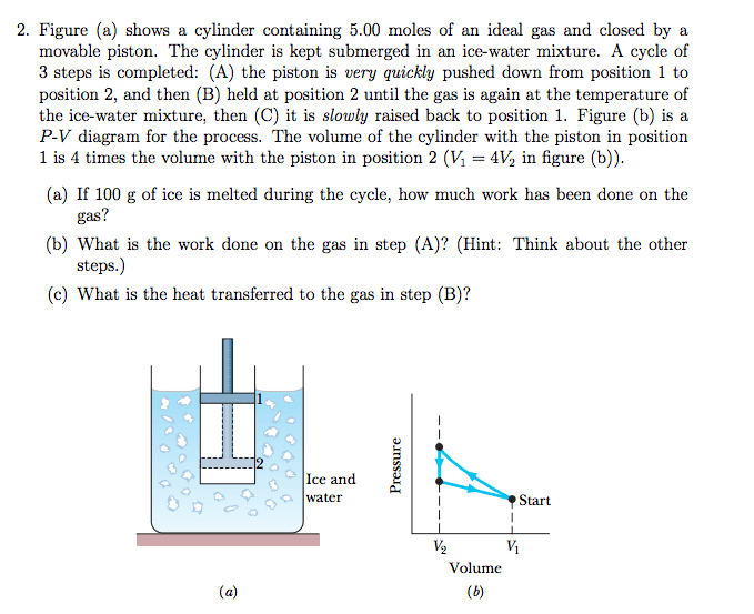

knc
[tex]PV = nRT \\ W = - \int_{V_i}^{V_f} P dV[/tex]
[tex]\Delta E_{int} = Q + W[/tex]
a)[/B]
Since this is a cyclic process, the change in internal energy of the system is 0.
[tex]\Delta E_{int} = 0[/tex]
The process causes some ice to melt, meaning heat transfers out of the system.
To maintain the model of a cyclic process the work being done on the gas (positive) is equal-but-opposite to the heat transferring out of the gas (negative)
Heat transferring into the water:
[tex]Q = m L_f \\<br /> W = - (-Q) = m L_f[/tex]
This is intuitive and makes sense, however I don't understand the relevance of the very quickly part.
I do understand that this suggests this is not a quasi-static process and that the system is not at equilibrium at all times. but I don't see what the implications of that are.
b)
Rearranging the ideal gas law and plugging into work equation:
[tex]W = - \int_{4v_2}^{v_2} \frac{nrT}{V} dV[/tex]
I don't think I am doing this part correctly.
c)
I don't know where to begin with this.

The implication is just that the gas suffers an unspecified irreversible compression during this step. Since the total heat removed during the cycle is specified in the problem statement, we don't need to know the details of this step.

Hint: Since, in step A, the piston is moved very quickly, there is no time for heat transfer in this step. You know the heat transferred for the entire cycle, and you know the heat transferred in step C.

We're not saying that the temperature remains constant. We are saying that no heat is transferred between the gas and the ice water. Do you know why this is not the same as saying that the temperature remaining constant?

Yes! Exactly! (Now, don't you like this site better than Physics Stack Exchange?)

We don't need to know the work in step A if we know that the heat is zero. We can integrate to get the work in step C, and this will give us the heat in step C. So the heat in step B is the total heat minus the heat in step C.

Step C is done very slowly, so it is isothermal at 0 C. That means that ##\Delta E=0## for this step.

The overall heat flow for the cycle is negative (-mL), so the heat flow in step B is ## Q =- mL_f - nRT \ln{4} ##.

$$W_{total}=-Q_{total}=+mL_f$$
$$W_C=nRT\ln{4}$$
$$W_A=W_{total}-W_C=mL_f-nRT\ln{4}$$

Oops. Sorry. You're right. My bad.

Sure. Now, can you explain why?
$$ Q_{net} = - W_{net} $$
$$ Q_a + Q_b + Q_c = -W_a - W_b - W_c $$
$$ \Delta E_{int,c} = \Delta E_{int,a} = 0 $$
$$ Q_a = -W_a \\ Q_c = - W_c $$
$$ -W_a + Q_b - W_c = -W_a - W_b - W_c $$
$$ Q_b = -W_a $$
Mathematically it makes sense. What physical implications does this hold?
Step B brings the temperature back down to the value before Step A. So there is no change in internal energy over steps A and B. Work is done in step A but no heat; heat is done in step B, but no work.
