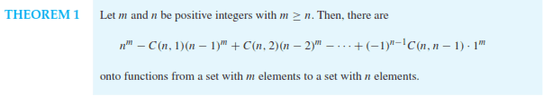

From: Discrete Mathemeatics and Its Applications 7th Edition Rosen pg. 561

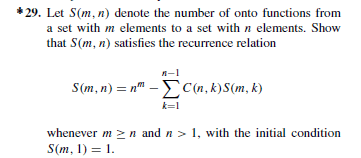

From: Discrete Mathemeatics and Its Applications 7th Edition Rosen pg. 512

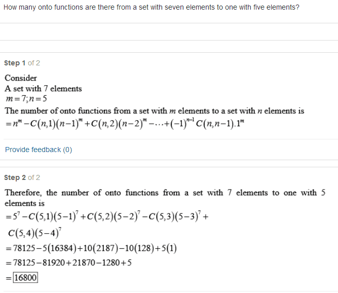

Random Chegg Problem from Google Search I'm using to verify with:

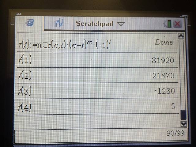

In the TI nSpire CX CAS, it's written like this:
And as you can see, the chegg problem I'm trying to verify it with doesn't match!
But I think it should! If I manually iterate the function like so:
The values are correct and what Chegg is showing. What have I done wrong in my equation?

Did you check that your summation formula matches the version that doesn't use sigma notation? i.e are all your ##m##s and ##n##s where they're supposed to be?
Likes 1 person
Wow, good call! I don't know how I constantly was missing that the (m-k) portion that should have been (n-k). And I even had it right in the non iterative equation.
