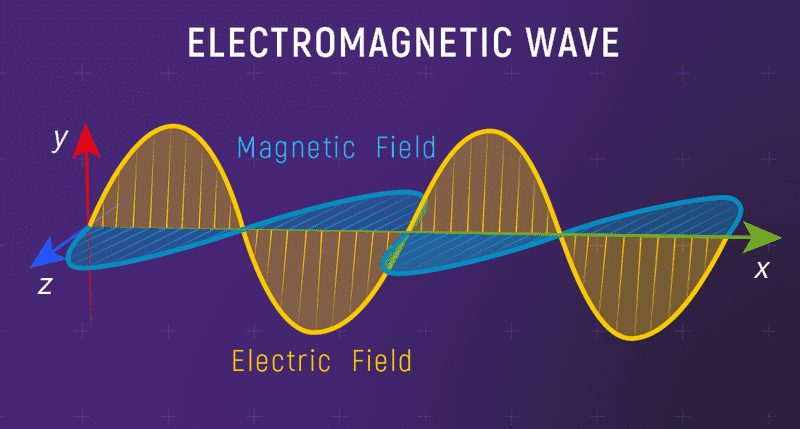

You have gotten good answers posted above. I would like to add one additional comment directed specifically at the following part of your question: "... what then keeps it going?"
For the moment, think about light as an electromagnetic plane wave as illustrated below (public domain image courtesy of NASA and Space Telescope Science Institute). The light wave propagates in the x-direction as shown. The electric field (yellow) oscillates in the y-direction and the magnetic field (blue) oscillates in the z-direction. The electric and magnetic fields are always perpendicular to one another, and perpendicular to the direction of propagation. Notice how the fields oscillate together. The important point is that changes in the electric field drive changes in the magnetic field, and vice versa. The significance of those changes is that the light drives itself--it self-propagates, it keeps itself going.
