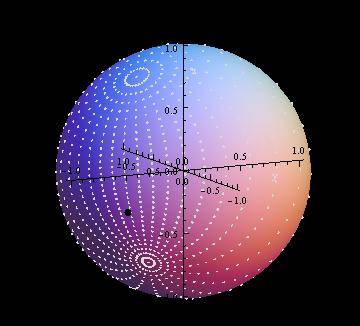

As I am right now working on illustrations for my book concerning exactly this topic, here is the graphics I have just made:
It shows how the standard spherical coordinate system on the sky is deformed as a result of the boost described by the following SL(2,C) matrix
[tex]\frac{1}{\sqrt{5}}\begin{pmatrix}2&1\\1&3\end{pmatrix}[/tex]
This particular matrix comes out from the polar decomposition of
[tex]\begin{pmatrix}1&1\\0&1\end{pmatrix}[/tex]
The boost corresponds to the velocity v=0.745356 c in the direction of the black dot. Only (relativistic) aberration effects are shown. Colors are accidental.
