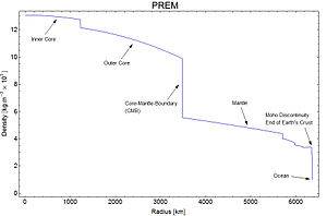

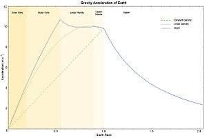

Sorry about that, it bothers me when others do that. Alright here is the same image, much reduced:
And the accompanying image of density as you go down to the center:
I have done the calculation on gravity at the outer core mantle boundary several times myself. I was happy when I found these graphs in a Wiki article about the Structure of the Earth.
ETA: Unfortunately they use different horizontal scales. The gravity graph has the effect as you leave the surface of the Earth and go out into space. The density graph is from the surface down.
