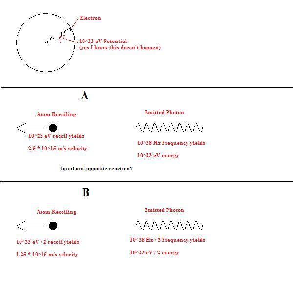

No, in my first post I mentioned a conceptual situation with three different frequencies for photons being emitted.
So, I resorted to MS Paint... Which is the case, A or B (or neither?) I'm guessing B, or something else. In case you're running the numbers in your head, I was using a mass of about 5*10^-24 kg for the molecule, assuming something emitting a stupidly high energy photon would be a yet-undiscovered element over 120, if it were even possible.

The Wikipedia article uses the classic energy-momentum formula. With the ratio of energy to rest mass in your example, you have to go relativistic. (There are two variants: the high energy approximation for v~c and the full formalism).
As you have correctly noticed in your first post ("*move*... fast...") v > c is impossible. Using relativistic mechanics will take care of that.

HA! I had an atom going faster than the speed of light. That's hilarious. You can tell I'm a newb at this stuff when I don't even check for that.
Ok, so this would accelerate that atom to roughly 7.88 * 10^-22 short of the speed of light, if I did the formulas correct. That's one fast atom, ok.
Now, would it be 7.88 * 10^-22 shy of the speed of light, or would it be the equivalent of half that energy (I'm not about to re-do the calculations)...
Basically, does that atom have 16000 Joules of energy in recoil, or 8000 Joules of energy in recoil?

Think energy, not speed. You know that your atom is moving highly relativistic, so use the approximation. It will give you the energy in terms of momentum without having to calculate \beta .(There are two high energy E-p approximations. You´ve already used one of them. Hint: the photon is a relativistic particle).
One (the last I hope) complication: since the atom carries away a considerable part of the energy, you´ll have to account for that in the calculation of the photon momentum from the start. Using the approximation, the math is not too bad. (think potential energy split into two parts: one for the atom, one for the photon)
