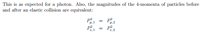

This has been confusing me for an entire hour or so.
The momenergy vector is defined as mass*((spacetime displacement)/(proper time)). I understand this as much, but I don't know how to apply it to situations. The following snapshot is from a question about a photon colliding with a stationary electron and being backscattered.
I don't understand how the conclusion about the magnitudes of the momenergy being the same can be drawn from knowing that an elastic collision has occurred. Kinetic energy is when total kinetic energy is conserved in the collision. But how does that translate to the invariance of momenergy vectors? There is something I am missing, but I don't know what.
This vector is usually called the 4-momentum. It's a good idea to stick to standard naming conventions, especially in a complex topic like this, so you don't have to translate, as well as understand, our replies.
Anyway, the 4-momentum is a 4-vector. Do you know what that means for its modulus when measured in different frames? Do you know its modulus in a particle's rest frame?

I did come across that modulus, but didn't see how it was important. I got the following from https://teachers.web.cern.ch/teachers/archiv/HST2002/Bubblech/mbitu/energymomentum_4vector.htm
Apparently the "length" or modulus of the 4-momentum is invariant for all inertial reference frames, because rest mass is invariant (though you can still have rest mass change in particle annhilation/creation, right?)
https://teachers.web.cern.ch/teachers/archiv/HST2002/Bubblech/mbitu/energy37.gif
Anyway, even with this interesting property, how do I understand the example I gave?
So because rest mass energy is invariant (and no particle annhilation/creation is occurring), we can equate the above? How does kinetic energy conservation (elastic collision) contribute to this conclusion? Or is it unrelated? I know both total momentum and energy is conserved (that seems to form the crux of most of the questions I have encountered concerning collisions), but I fail to see the significance of the elastic collision?

Working in the rest frame of the matter and supposing it is struck by a photon coming along the x-axis so they both recoil in the x direction, we can say for the matter
momentum before ##P_0=(m,0,0,0)##, momentum after ##P_1= m(\gamma,\gamma\beta,0,0)##.
The photon has momentum ##k## before the collision so the 4-vector is ##p_0=(\nu,k,0,0)## where ##k=1/\lambda =\nu##, and after the collision the momentum becomes ##k'##. For energy conservation the energy before must be the same as after. The energy is the first term of the four vectors ( with ##c=h=1##) and the momentum is in the other terms. I don't have time for more right now.

Hmm...not sure I get it or not. This is a process I have applied in my working, but like I have reiterated before - I don't understand the rationale behind equating the 4-vector for momentum. In fact, the way it is written, the 4 vectors are distinctly different! Is is just a rule of thumb that the magnitudes are invariant? Or does making that choice require some initial conditions?
I just need to know why we are equating what I am seeing. I am terribly sorry if I have been vague at expressing my question.

definitely not. The 4-vector is the original tensor. The magnitude is invariant under Lorentz transformations and it obeys tensor algebra, eg ##u^\mu u^\nu## is a rank-2 tensor.
But surely you know this because the expression ##\sqrt{\bar{P}\cdot \bar{P}}=m_0c^2## says just ##u^\mu u_\mu=m_0^2c^4## and ##m_0## and ##c## are both scalars.
The important thing about tensors is that tensor contractions to scalars are invariant under a big class of transformations. The definition of a tensor is that the contravariant indexes transform with the inverse of the covariant transformation so when a contraction is made the two transforms always cancel to unity.
The magnitude of the momenergy 4-vector is the invariant mass of a particle or system. You should find this in your textbook. Can you understand why undergoing an elastic collision doesn't change the invariant mass of either particle?
For extra credit, do you understand why an inelastic collision (assume this is between systems of particles rather than particles) could change the invariant mass?
