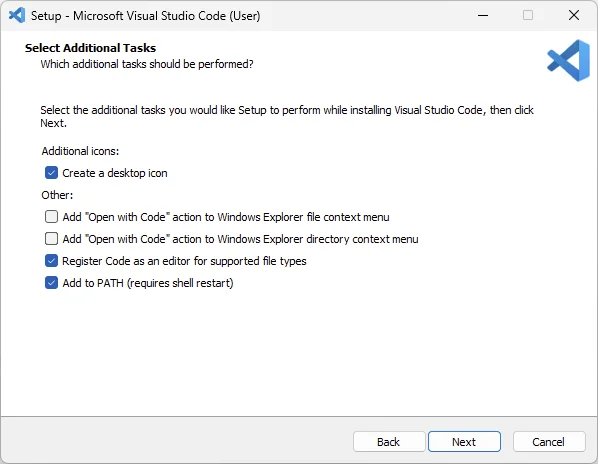

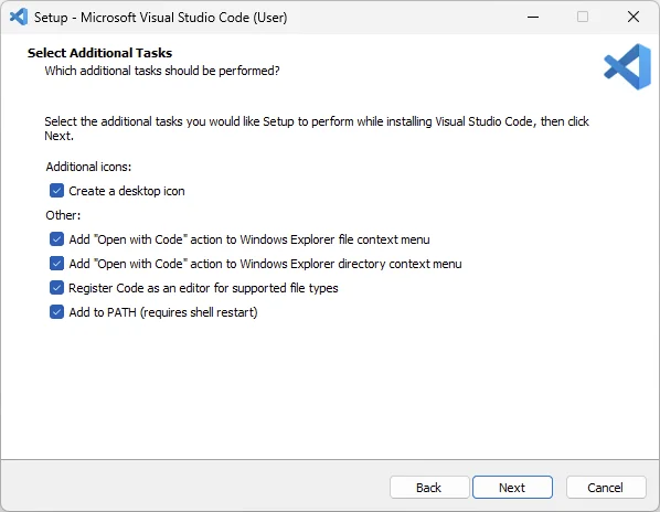

As luck would have it, MS have screwed up the latest VS code Windows release yesterday (auto-updated for most people): the 'Open with code' option is removed from the Explorer 'right click' context menu - see this issue.
To fix this, download and install the previous, June 2025, version 102, making sure the 'Add "Open with Code' options are ticked.
You can either stay with this, or download and install the current version but untick the 'Add "Open with Code' options like this:
Because this is broken it will actually leave the context menu entries unchanged.
Or just wait for a patch - it is already in the nightly build but no target date for release yet.
