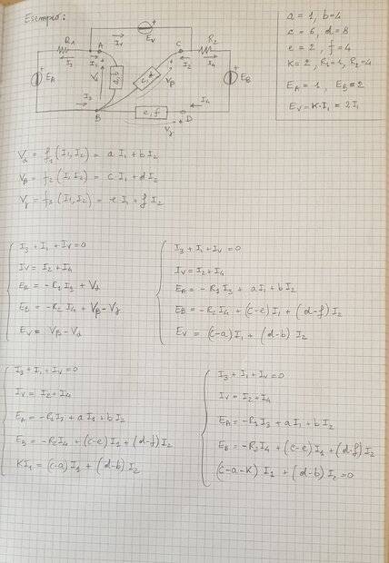

Hello,
I'm struggling with the conditions under which makes sense employ a two-port 'external' representation of a quadripole (four-terminal electrical network) when interconnected to an external circuit (to take it simple assume a linear + permanent electrical network).
Starting from circuit theory I elaborated the following:
Take a quadripole (four-terminal network) interconnected to an 'external' circuit. Do not place any constrains about the current entering in each of the four terminal (no 'port' constrains for the currents). From a network analysis point of view we can proceed as follows:
  1. choose a tree spanning just the quadripole internal structure (directed graph) up to its four terminals
  2. extend this tree to the overall 'external' network starting from those 4 terminals
  3. write the equations for the equilibrium of currents at each node belonging to the complete network (actually N-1 nodes suffices)
  4. write the KVLs for the voltage equilibrium at the fundamental loops (f-loop) w.r.t the chosen tree
  5. write the BCEs (Branch Constitutive Equations) for each element branch
We can now proceed as follows:
  • add 2 constrain equations for the 'port' current condition at each of the 'coupled' terminal pair (port)
  • add 2 auxiliary unknowns for the port voltages + the 2 related equations defining them w.r.t the branches of the chosen tree spanning the quadripole internal structure
The set of equations involving only the unknowns for branches inside the quadripole, is formally the same as the set of equations for the same quadripole closed on 2 external indeterminate bipoles (one for each port). A solution of the first system of equations is actually also a solution for the network you get replacing the quadripole with (one of) its 2-port network 'representation' (note that the set of equations for the last one is actually obtained as linear combinations of the equations belonging to the first one).
The other way around, a solution of the second one (the complete network you get replacing the quadripole with its 2-port representation) might not be a solution of the first one (the fundamental loops involving the not 'coupled' quadripole's terminals are actually not included in the equations set)
Thus, we have to explicitly check for those KVL when taking in account any solution of the last network to be sure it is actually a solution of the network we started with.
What do you think about, does it make sense ?
ps. same question shows up in other (italian) forum.

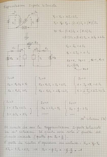

Just to take an example consider the following circuit having unique solution. If we choose to employ the quadripole (four-terminal network) two-port V(I) representation we get a system of equations having this time infinte-1 solutions (we can pick for instance I2 as parameter).
As shown below (sorry it is in Italian :wink:) adding the disregarded KVL equation the solution became unique (it is the solution of the first system for I2 parameter equals to ##\frac {3} {4}##).
This actually seems to be an example of what I said above: we need to explicitly check the solutions we get solving the network when two-port network model is employed.
Handwritten worked example on squared paper: a resistive circuit with a voltage source E_V and sources E_A and E_B, followed by two-port matrix equations and several systems of linear equations in I1, I2, I3, I4 and I_V.
Handwritten notebook page with several systems of linear equations in I1, I2, I3, I4 and IV, followed by a boxed solution I1 = -1, I2 = 3/4, I3 = 1, I4 = -3/4 and a note reading 'soddisfa le condizioni di porta'.
Handwritten notebook page deriving a two-port balanced representation of a circuit, showing port voltage and current equations, a circuit schematic with resistors and sources, and a set of linear equations with solution notes.
