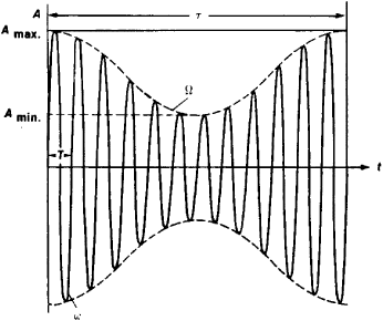

Say you are transmitting AM radio signals. You input an audio signal of 1khz which is used to modulate a signal of 1 mhz. The heterodyning process outputs 4 different frequencies, the audio, carrier, sum, and difference. But where are the sum and difference?
If I look at a graph of the modulated waveform, I can see the carrier and the audio (as amplitude variation in the carrier), but where are the other two? The sidebands as they are also known. I'm not seeing how you add and subtract the frequencies if you are using the audio signal to modify the amplitude of the carrier. When you transmit the signal from your antenna, are you sending power through the two sidebands as well, or only on the main carrier frequency?

That makes sense. However I think I'm failing to understand how changing the amplitude of the carrier creates two different frequencies in addition to the original two. It's just not "clicking" I guess.
An ideal mixer multiplies two signals. Use trig identities to write
cos(fm)*cos(fc) = cos(fm+fc) + cos(fm-fc)] / 2

One way to look at the creation of sideband frequencies is to work the problem in reverse. A function (signal) can be decomposed into purely sinusoidal components. You want to create a AM single frequency modulation time-domain display on your oscilloscope display. To create this display you have RF frequency generators and a summing network. What set of frequencies would you have to set the RF generators to recreate the AM modulation display.

But the easiest way to show how AM produces sidebands is to start with a formula which describes Amplitude Modulating a carrier wave with angular frequency ωc with a cosine modulating signal of frequency ωm does:
A =A0Cos(ωct)(1+Bcos(ωmt))
A0 is the mean amplitude of the carrier and B is the Modulation Index - the depth of modulation.
This will give you the familiar picture of a carrier amplitude varying in level, as the modulation varies, and around its unmodulated amplitude. (The envelope picture). That expression can be transformed, using the basic multiple angle trig identities into
A = A(cos(ωc) + Bcos((ωm+ωc)/2 + B((ωm-ωc)/2)
which shows you that the AM signal can be described as a carrier and a pair of sidebands that have up to half the amplitude of the carrier.
You don't need to do any Fourier analysis for this - in the simple case, it's just a bit of simple trig. And, if you don't like trig, then steer clear of Fourier - it's harder still.
